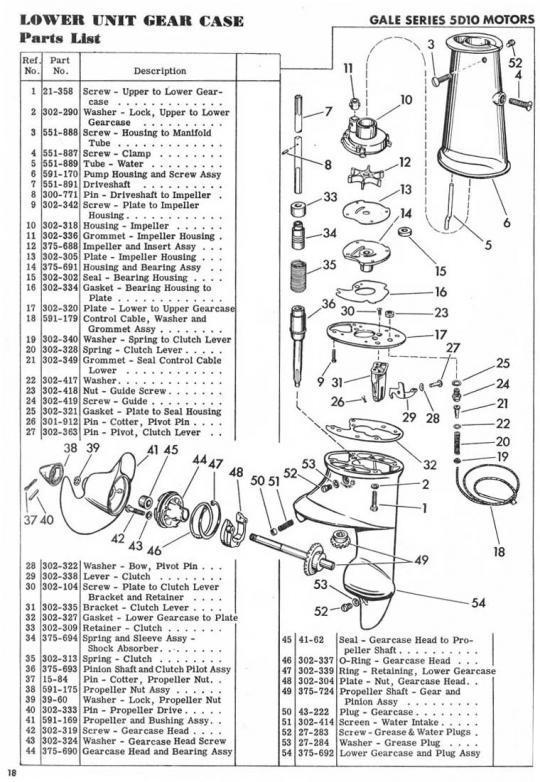

Pg 18 Lower Unit Gearcase.jpgYou will encounter the clutch spring when you do the water pump job. This is not your exact model but close enough to answer the question. #39 is the clutch spring, #29 is the lever that interrupts the tab as it rotates by.
Thanks everyone for the info. I'm sure you meant to refer to #20 as the spring.

Yep, typo on my part. #35 is the clutch spring. Works like wrapping a rope around a tree. The harder you pull, the tighter it gets.
