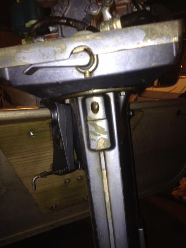

I came on here for advice as I can work on small engines and cars but boats are little different story. Here are some pics

I tried to upload some more pictures but having problem with the up loader. That motor has ran like that since I've had it for at least the last ten years. So I wouldn't call it abusing the motor. I'm sorry sounds like you really know a lot about boat motors and working on them. Not all of us are that fortunate.
The hole in the picture is the exhaust relief for idle.--Some water will spit out of there when engine is idling.---The later motors in say 78 came with a dedicated " pisser " that show a steady stream of water whenever the motor is running.
Thank you. I wan't sure it was a pisser hole or what. Like I said I wasn't sure about the water coming out of it. I don't know a lot about boat motors. The motor has never gotten hot. I just wanted to know about that and the starting hard when in the lake compared to using hose.
Keeping it simple.... Water fills the long exhaust housing between the lower unit and powerhead so as to keep it cooled somewhat. If not for this feature, the paint would burn off with its first running. That exhaust relief hole you spoke of is just that... a relief hole which allows the water to escape along with the exhaust when the water reaches a certain height. If not for that relief hole, the water would enter the bottom cylinder eventually.
The water telltale outlet that the later models incorporate (plastic fitting at the starboard aft portion of the hood pan) could be added to your engine if desired.
