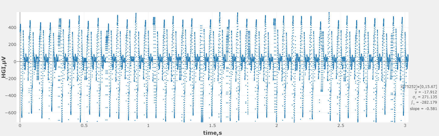

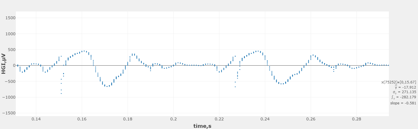

Purchased a small Tachometer and was super excited that I could now see what was going on. Motor sounds normal and it shifts gears pretty smoothly.
Turns out this tachometer is seeing 1500 rpm too. The settings are correct but the result did not seem correct.
So our curiosity has been peaked!!!
My son brought home a lab in a box they use at his university to help diagnose the issues we are seeing on the Tachometers.
Below is what he has said and we have included a couple of pics of the data points. The tachometers are picking up additional signals on each cycle(firing).
[The tacometer was reading something that had to be too high and we didn't really trust the old one.To just simplify the whole process we hooked up a little handheld device that could measure and plot the
voltage passing through our tacometer coil (basically an oscilliscope kinda). From there we just manually counted the
troughs in our signal and divided by time to get our revolutions per second. ]
Thought I would share this in case anyone else has seen this or thought it might be interesting. We are taking the motor out later this week and I will report back how it ran.
