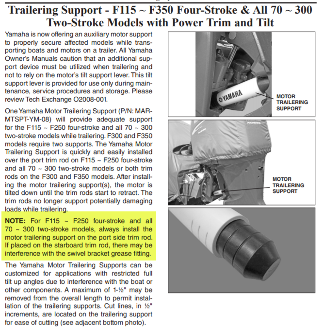

My buddy has a Parker with a Yamaha 150, approximately 11-15yrs old.
We returned from fishing, and I put the engine support on the starboard side post, and lowered the engine onto the support.
Apparently the support only goes on the port side, as when I lowered the engine onto the support, it snapped off a zerk fitting that also serves as fixing point for a ground wire.
Is this a standard configuration? I can't believe Yamaha would design something like this so that if someone bought a boat used, they would make the same mistake I did.
Is there a workaround to either relocate the ground wire and put in a lower profile, or angled, zerk?
Or, is this just something to live with, letting anyone who uses the boat know before they lower the engine?
