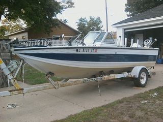

Why would you buy someone else's troubles? I disassembled a 112spl today that had low compression on one cylinder. It turned out to be the center main bearing shattered, which would explain the piece of metal imbedded in #4 cylinder head. The engine is junk. Sure, there are common problems and then there are the not so common problems. It may have low compression due to being burned by a clogged carb or a double firing ignition system or a bearing that let loose. Run from this as fast as you can or simply talk him down to a really low number on the boat.
