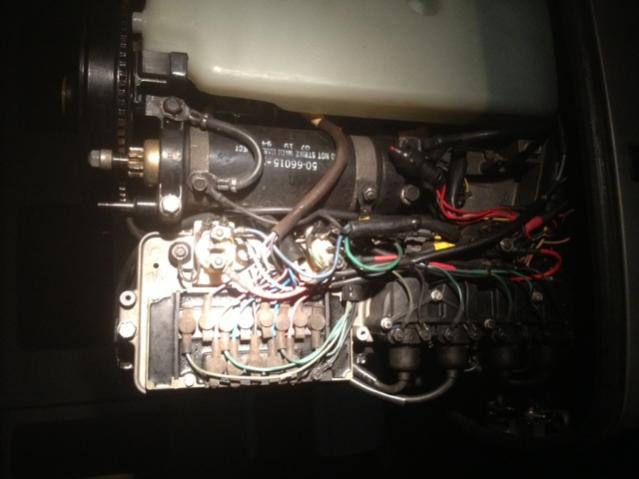

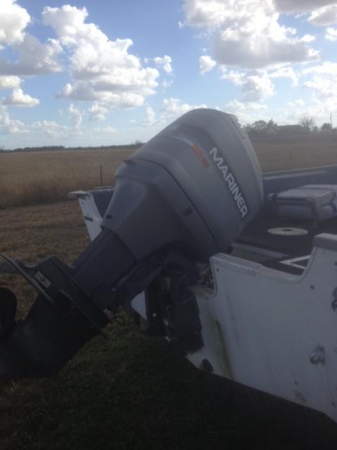

I found the serial # tag but I can't read any # at all on the tag. There is a # that I can see when I tilt the motor all the way up 3408-818904-C1 I don't think it is the serial # but this is the only # on the engine. The one on the serial # tag is gone.( I wish it was stamped on the tag instead of printed) I don't have the title yet to get it from there. mariner 115.jpgmariner.jpg
I disconnected the black wire with yellow stripe and still no spark.IMG_0363.JPGIMG_0361.JPG
