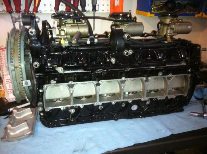

Im having trouble turning the crank when I bolt up the transfer port covers. I'm only using loctite form-a-gasket. Am I losing clearance
by not using a gasket and putting pressure on the cylinder wall. As soon as I take it off it turns nicely again. I suppose I could blue the inside of the t.p. cover. Any feed back would be appreciated.

I used a cork gasket in the gasket groove and smeared a little loctite on the cork just because. photo (15).jpgphoto (14).jpgIn the close up shot of the cover you might be able to see the shiny portion where its contacting the meat in the middle of the port. I decided to omit the gasket since there are no machined faces or bearing clearances to set here. I talked to
a boat shop in the area and he has never heard of such an issue either. well, its there. and it also cracked the aluminum on the #5
cylinder. The plan is to v out the crack and epoxy it.
