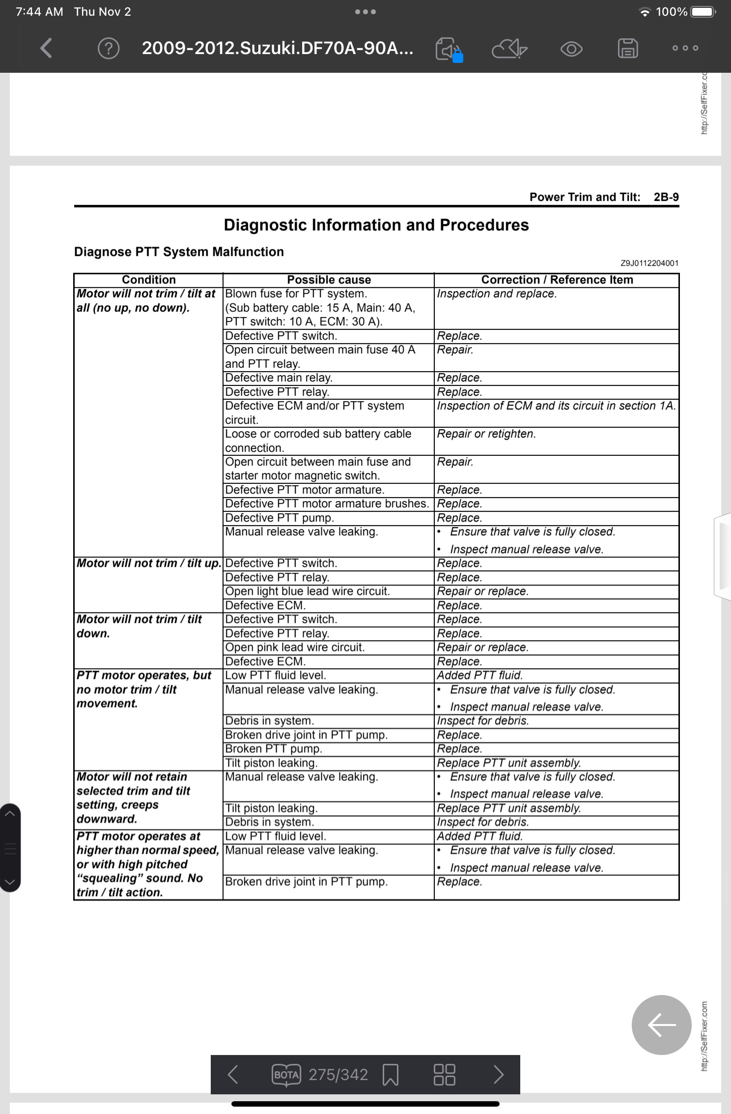

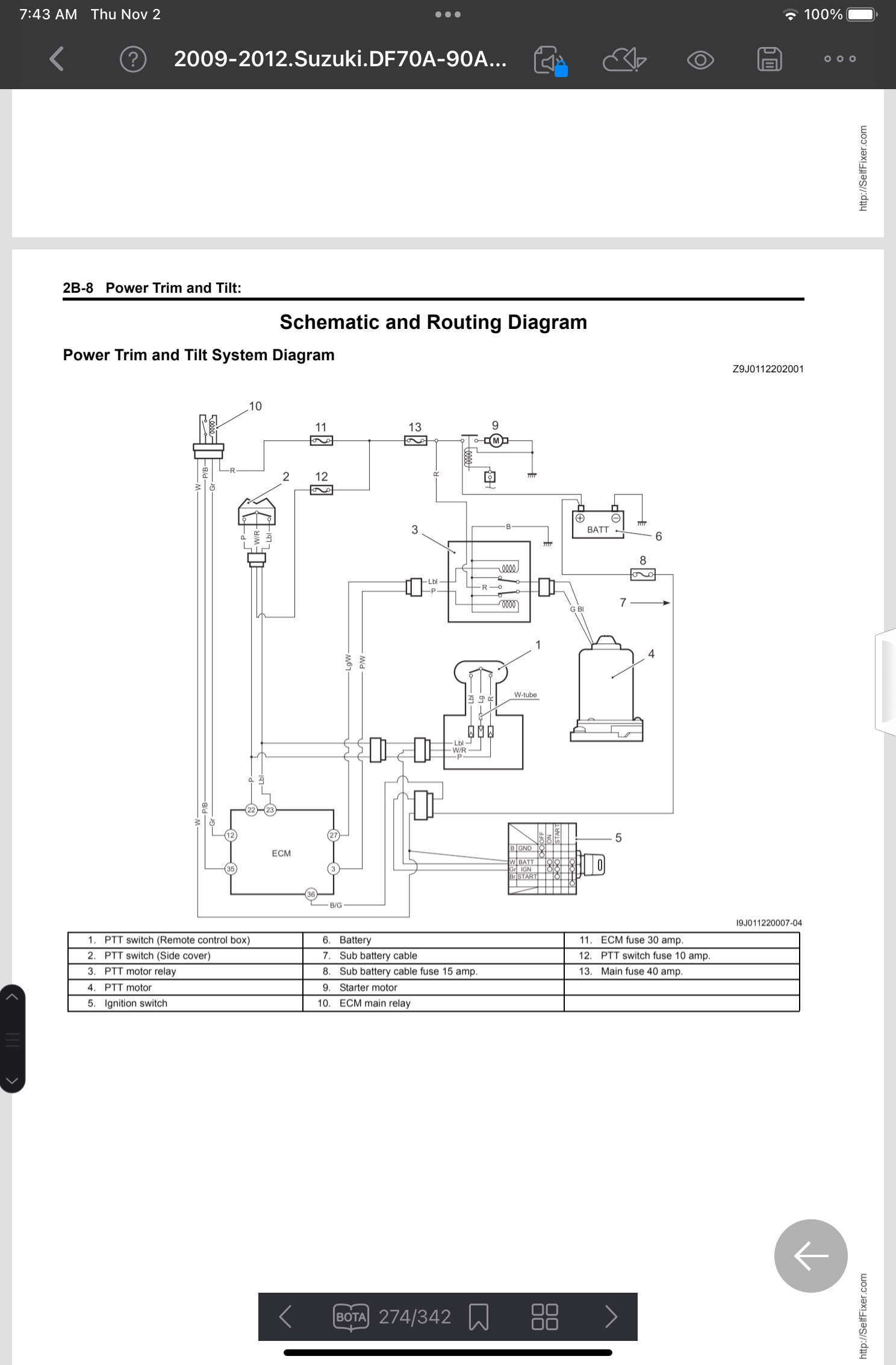

Hello all,
As stated my motor is not trimming. It is not batteries, all connections and wires are solid and appears no corrosion (it’s a fresh water engine so no salt). Once in a while I can get the motor to trim up a bit but then stops. I can hear a clicking sound when I try to trim up or down from the trim switch located on the motor itself. It sat for a couple of months. I went to get it ready for a tournament and noticed the trim was lazy, and figured the batteries were low. After I had it charging for a few days the trim barely would move. Has anyone had similar problems with their older DT? Any suggestions on where I can start the trouble shooting would be great. Thanks in advance. Cory
