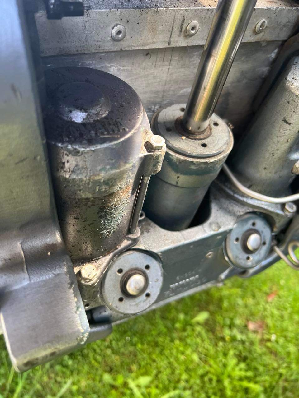

Hey guys, I’ve bought a 2t 50hp Yamaha outboard and the tilt trim motor is not working, I’ve bypassed the relays and everything there is in working order and when I use the tilt switches it’s still clicking at the solenoid but no movement, I’m having trouble finding out what year the outboard is leading to difficulties in finding the correct tilt trim motor for it. the make and model number are as follows: 50DETO 6H5 L 595804 G any info on this would be very much appreciated
