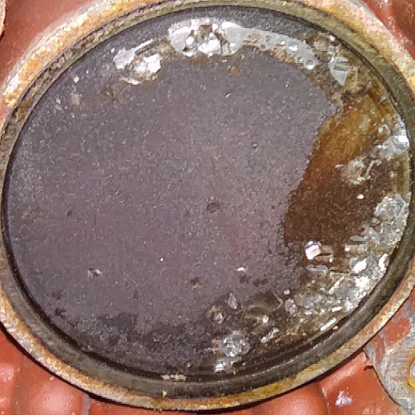

Lost power while waterskiing. Limped home. Low compression on center cylinder.
Pieces missing from the center piston.
Center piston connecting rod sloppy on the crank.

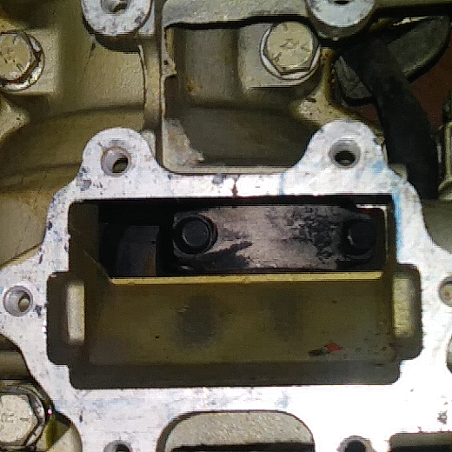

Center piston rod cap is white and dry, the others are black and damp.
There was no 70 HP motor in 1970 !!---Or is it a 1974 model ?-------A plugged / partially plugged carburetor can really mess that up.---Or oil recirculation was blocked somehow. ------Time to look for a bunch of repair parts I guess.
A 5/16" 12 point socket.-----Not really weird.-----Standard for super high strength rod bolts made with alloy steel.----About 180,000 PSI in yield I believe.-----The motor has to come right apart.----Can not be repaired the way you are trying !!

I want to take out the piston to see the skirt (curious). 5/16 - 12 pt isn't in my toolbox (yet)
Why does the top of the piston look like this? Debris from the bearing carried through the intake port and bounced around?
I got got a 5/16" 12 pt socket today!
One tiny piece missing from a connecting rod bearing retainer and both retainers broken. All 16 rollers accounted for.7470 bearing retainers.jpg
