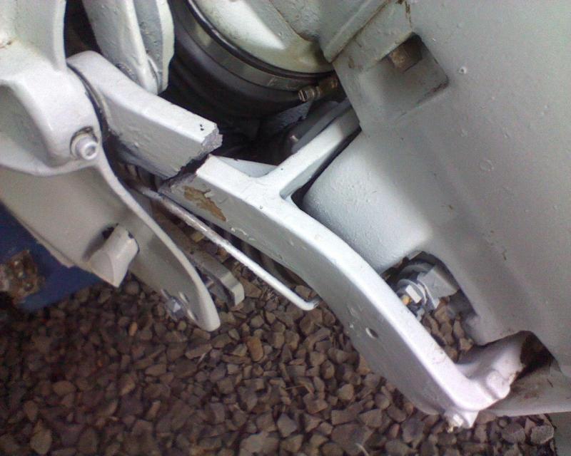

Edit: all suspension forks of this style will interchange with each other....., but note that the 250 suspension fork has bronze inserts at each side.
(SEQ #14 here)
Some suggest that this fork is not quite as strong.... and I agree.
For V-8 power, I'd avoid the 250 suspension fork.
