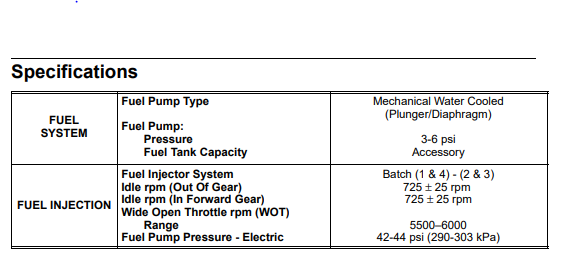

Fuel pressure seems to high. What does your service manual say?

Sorry but fuel pressure is constant due to high pressure pump and pressure regulator, and pressure is in spec's
Is that from the service manual? Have you read the part in the service manual where it refers to testing the fuel pressure regulator?
