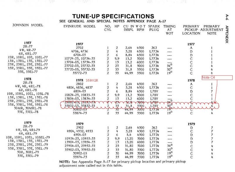

Hello eveyone ive been trying to wrap my head around this just cant get it figured out. i looked in manual found my code for 35802R it was C4. So i looked into the steps for C ill do steps 1 & 2 also C5 per note 3.....
