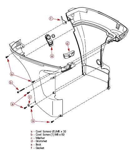

I need to replace #34 in this diagram,, the 45 degree elbow fitting:
What would you remove to be able to replace the fitting, I guess removing the lower cowl is a good idea, but how do I do that?
