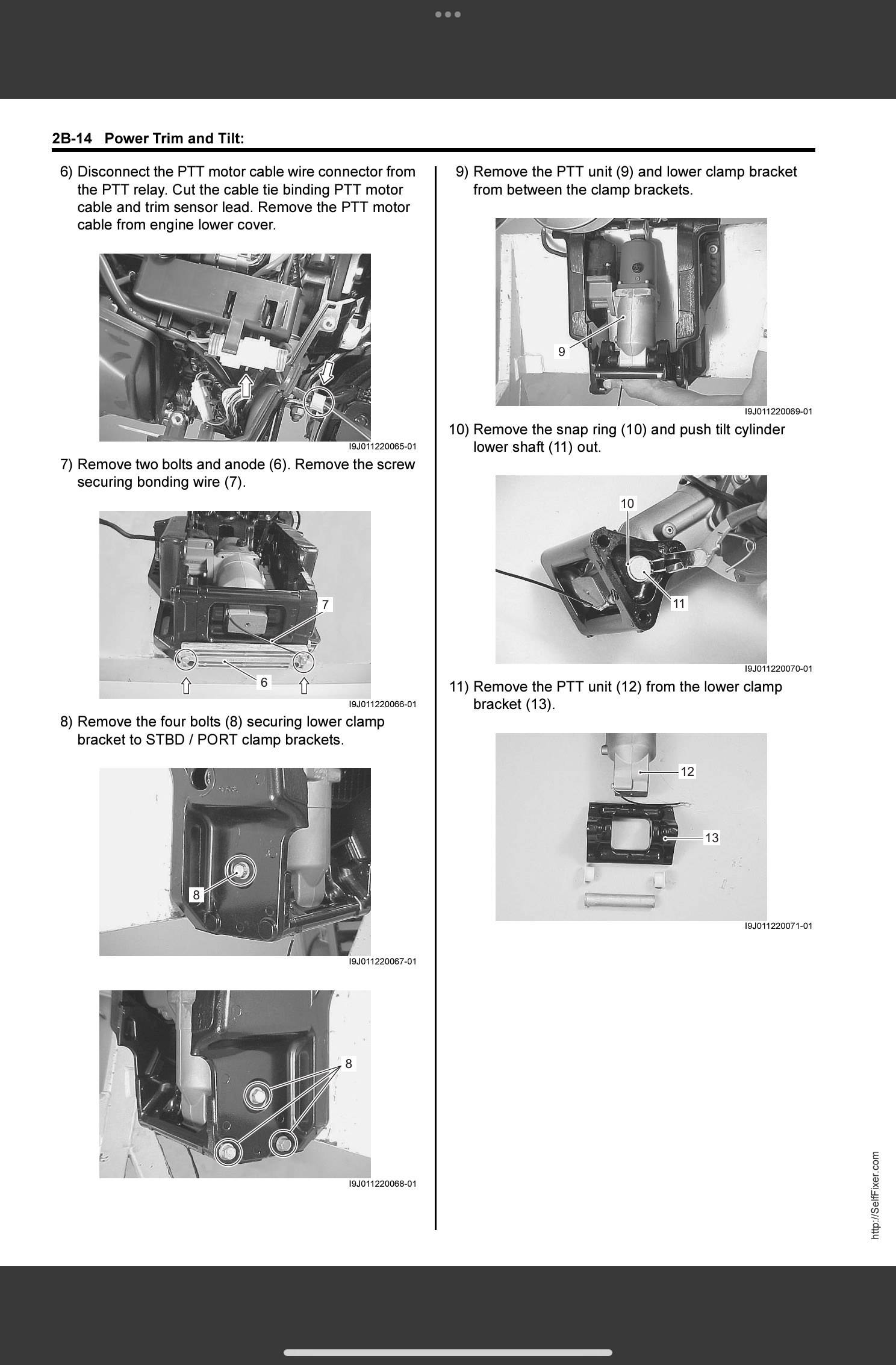

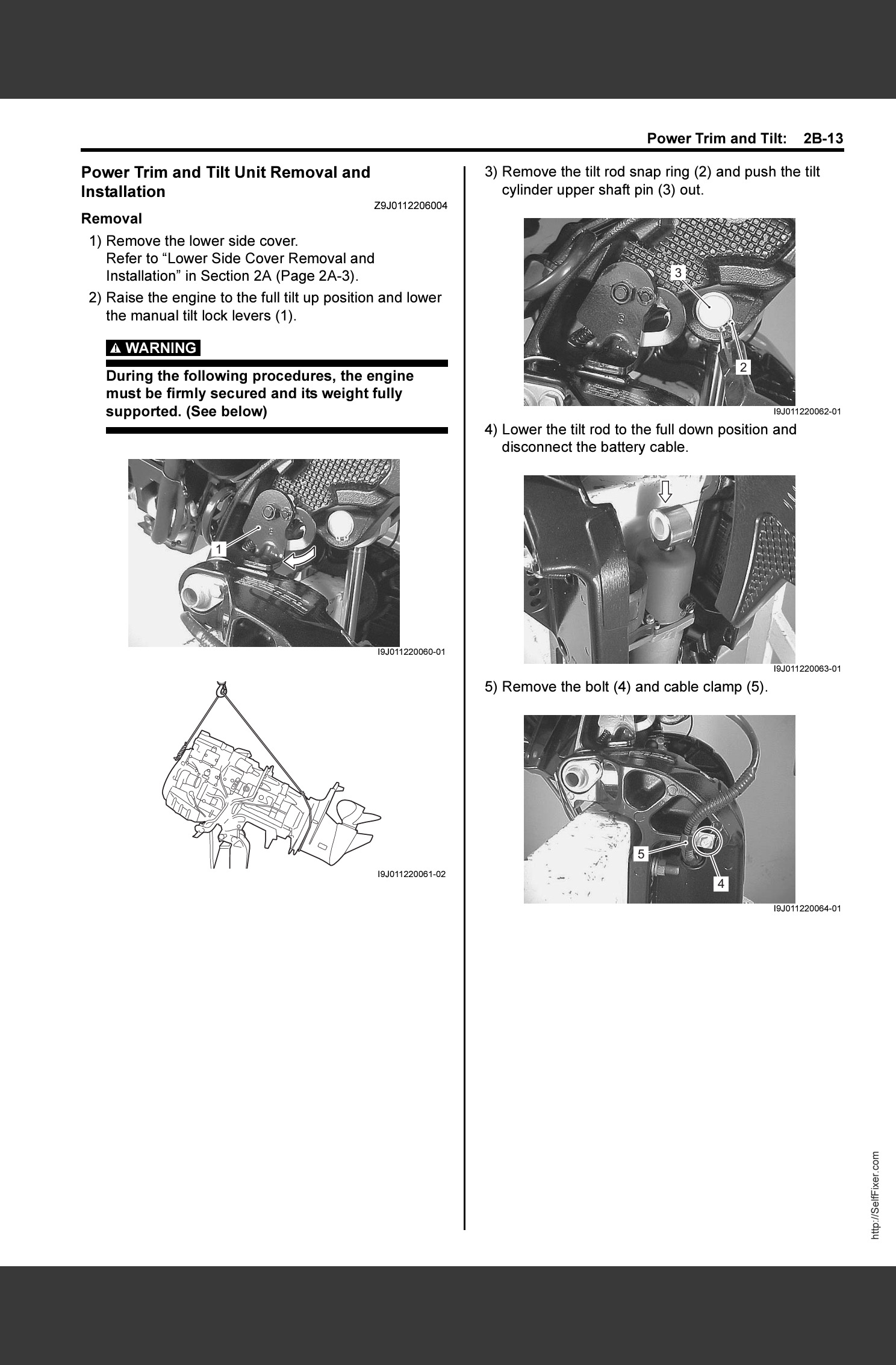

Point #6? From a 2009 DF90A service manual
View attachment 31796View attachment 31797
Thanks. That is interesting. It looks like it should be possible to pull out the cable without dismantle the connector according to the service manual.
The problem is that as far as I can see on my DF140 motor. The socket is too big to be pulled out via the cable entry in the cover. Also the entry is located underneath so it really hard to see.
