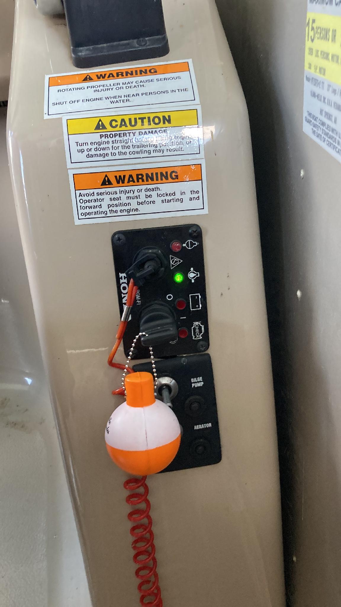

Hi all. Sorry I don’t have more information about this engine. My girlfriend’s father has a tri-toon with a Honda outboard on it. Sorry I don’t know which model. He said he is getting a buzzer and light on the power and shift unit. He said it was an oil circulation warning. I tried to look that up online and couldn’t find anything on that specifically. I told him to check fuses and connectors but was hoping someone here has specific experience with this and some possible quick solutions to check or test? Thank you in advance. Unfortunately I don’t have more information or photos

Ok so I just talked to him. He says the oil light is green and the motor is not running in “limp mode” but the dinger is going off whern the motor is running

He said the stream is flowing. The oil light has always been green. Sorry he gave me incorrect info earlier. When he turns the key on the alarm goes off. He said it isn’t going into limp mode. Wondering if there is a way to reset the alarm??? Maybe it’s a ground or CO2 sensor?

OK, you turn on the key and get an alarm before starting the engine, is that correct?
When you turn the key on, do you get two rapid beeps and all four console lights flash briefly?
At this point, with the key on and no attempt to start, the red alternator light should be on and the other three lights should be off. Is that correct?
Is the alarm continuous, intermittent (about once every second) or rapid (about 2 times per second)?
Now, when you start the engine, the green oil pressure light should be on and the other three red lights (alternator, overheat, and MIL (check engine)) are off. Is that correct? At this point what does the alarm sound like - continuous, intermittent, or fast intermittent?
Is the engine slow starting? If so, you could simply have low battery voltage. Charge it and try again.
And are you sure that this alarm is from the engine? Maybe a bilge pump alarm, dying CO (carbon monoxide) detector alarm, or windless alarm.
