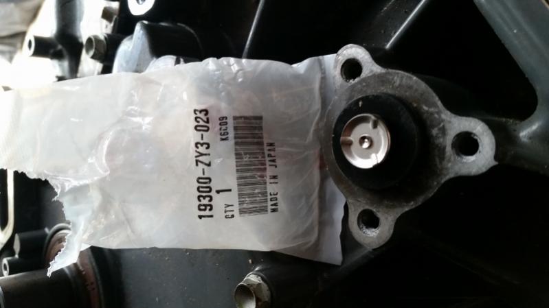

So, finally getting my new BF200 block swapped out. Puttering along just fine until...Installing the thermostats, the port side mounting is diferent on my old block. The deck is about 3/4" lower. The thermostat falls into the hole. The starboard side is fine since the housing was taken off of the old block and installed on the new one. The port side has no housing to remove. On the old block, it is part of the block casting.
This is the thermostat deck height on my old block
This is the thermostat height on the new block
This is the correct thermostat, new part, in the old block
Same thermostat in the new block
There should be another part I need, some sort of spacer I guess?
