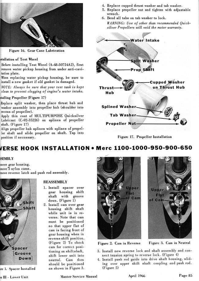

Original lower unit destroyer on rock. Replacement is having issues shifting and running. Engine starts and idles fine but when shifting into forward, engine dies repeatedly. After several attempts I can slowly nurse RPM's up until it stopes at about 3/4 throttle. Not enough to go on plane. When stopping and shifting to reverse, the shift is difficult and the engine quickly goes to high RPM's. I will drop unit again tonight but i'm wondering if anyone has experienced this. Not so sure I'm getting shift shaft correctly alligned.
