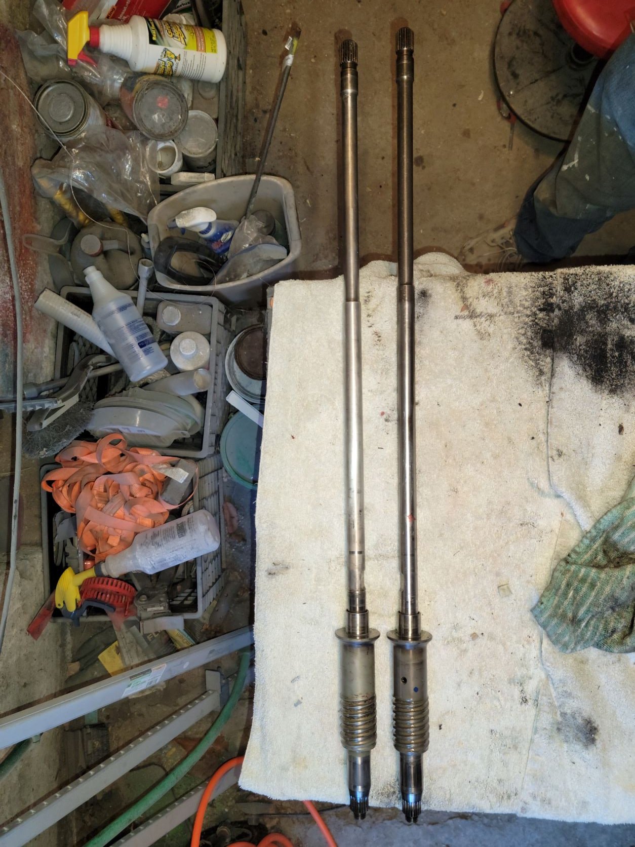

After struggling for about an hour or so I realized the driveshaft is different!
The one from the '03 LH 200P is a bit longer so it would not go all the way up.
I'm thinking I could use the driveshaft from my other rh rotation lower.
