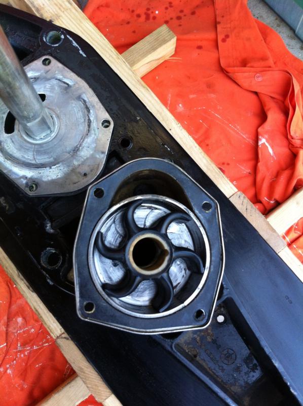

Back on the Settimo Velo getting ready for sea trials at last! However, My image.jpgcounter rotating drive isn't picking up cooling water from the flush muffs following the service I did. Nothing getting through to the engine. Standard rotation drive is fine, so I got that right! The manual calls for the impeller blades to be curled counterclockwise, so I thought this was right (see picture)? If it is right, where else could the problem lie? ... The drive is engaging and prop rotating.

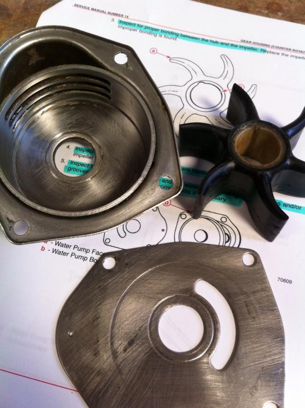

Thank you all for the replies. When I detected the problem I pulled the hose off at the thermostat housing (yes it is raw water cooled) to check for water coming through with the engine running, but there was nothing. I then removed the bottom half of the drive to check the condition of the impeller, which looks OK to me although I didn't replace it when I serviced the drive and it's been standing now for a while! I then checked for blockage by pouring water down the hose removed from the thermostat and it went straight through, so that seems to be clear. So, I think the problem is lack of water coming in, being picked up by the impeller ... I'm thinking that I should get a service kit to replace the impeller and seals around the impeller housing and outlet tube etc. or is there anything else I should look at first?
Took a closer look at the impeller housing to find some wear, although I'm not sure how much this would lower performance. There are grooves in the plate and housing about 1/32 deep worn by the centre of the impeller. The impeller itself looks worn down a little on one side and there is some wear on the ends of the blades caused by the outlet slots in the housing. None of this looks that bad to me! How reliable are flush muffs when it comes to lifting the water to the impeller? Anyway, now it's out I'm thinking new impeller, gaskets and face plate?

Your impeller is set, hence it will not work efficiently.
Get a quick silver or Mercury impeller kit without the housing. I sand the inside of the housing with a little 1000 grit paper, add some soap and reassemble. Do not forget the rubber that slides down over the shaft after the housing is back on. Put it together with the new impeller and it will be fine.
CCW shown in the picture w/the cover upside down but installed the impeller will be CW. It's been a few years for me...I could be wrong...turn it around?

I dropped the lower drive unit, replaced the base plate in the impeller housing and fitted a new impeller. It's working great now:http://www.youtube.com/watch?v=w-IKSGiZHWs To be honest the old impeller looks fine to me and I am now suspecting a possible water pressure issue at the flush muffs as the cause! Re-assembling the upper and lower drive units on my own - with the upper still attached to the boat - was a challenge but I devised a way to do it with some big G-Clamps on the cavitation plate, taking care to line up the delivery tube (from the impeller housing) once I got the drive shaft located in the upper housing.
