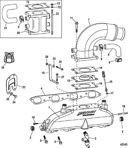

Your looking at exaust temps not engine temps I think. If there a 2 wire sensor, read that value when cold and put a resistor of that value across the wire

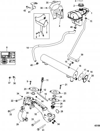

Your error is warning you about #11 in your parts breakdown, not exhaust manifold temp.I checked and changed these two (№16)
