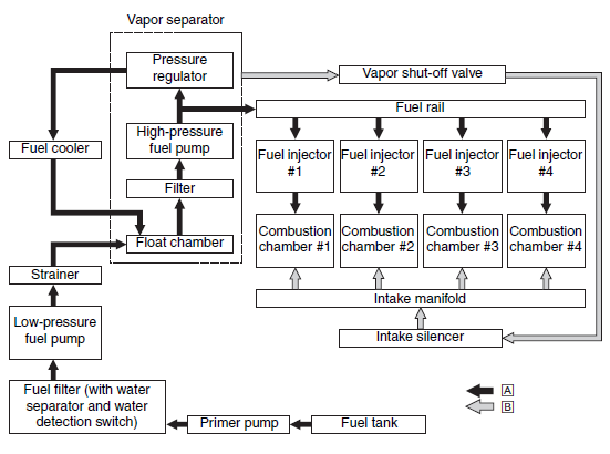

If you can access a service manual, there may be a fuel curcuit diagram near the front that shows how the Solenoid valve controls venting. Mine had an excellent diagram that makes it easy to troubleshoot fuel flow issues.
