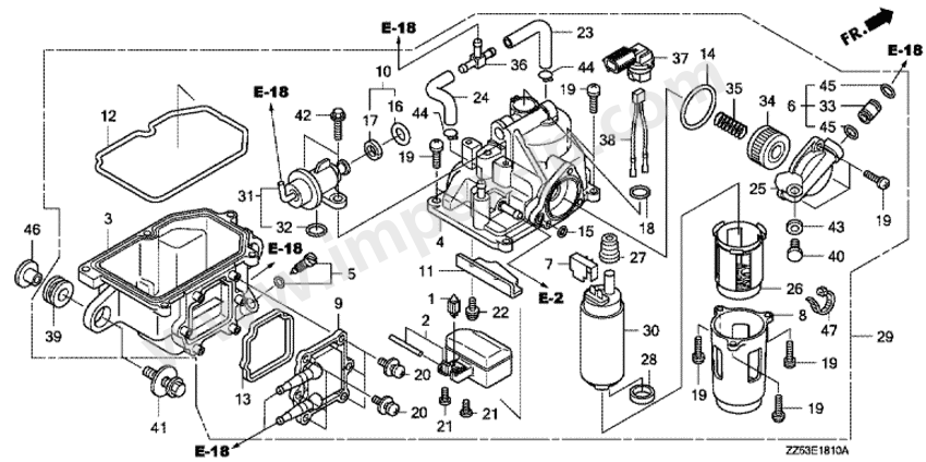

undo the 3 screws holding on the fuel pump cage, down inside the reservoir.
Gentle remove fuel pump and offending grommet.
If you get stuck Impex has a full diagram of each part, linked below.
https://en.impex-jp.com/catalogs/outboard/honda/40/bf40d-lhd-efi-overall-14298.html
