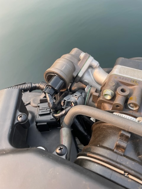

So, my #1 idea about what might cause a slight hesitation at a pretty specific rpm over and over again would be Throttle Position Sensor (TPS).
This sounds like a "bad spot" in the TPS potentiometer.
I would do a "sweep test" of the TPS using an ohmmeter to see if there is a resistance "glitch" as the the throttle is slowly opened and closed.
However, this test, using an ohmmeter, doesn't always yield good information.
A digital ohmmeter might not actually catch and display a fault well enough for you to see it happening. A high quality graphing meter would have an easier to read display but not always. (see below)
I have kept my old analog Micronta (Radio Shack) meter all these years because the sweep hand of the meter is very easy to follow when checking TPS.
But....
...because the event can happen so fast....(multimeters are slow)
....and might not even occur using the meter as the power source....
Most "good" auto shops keep an oscilloscope handy to check components like this "LIVE" while powered by the vehicle to obtain accurate results.
Besides the TPS, other things that come to mind for this would be an oxygen sensor or a MAP sensor.
