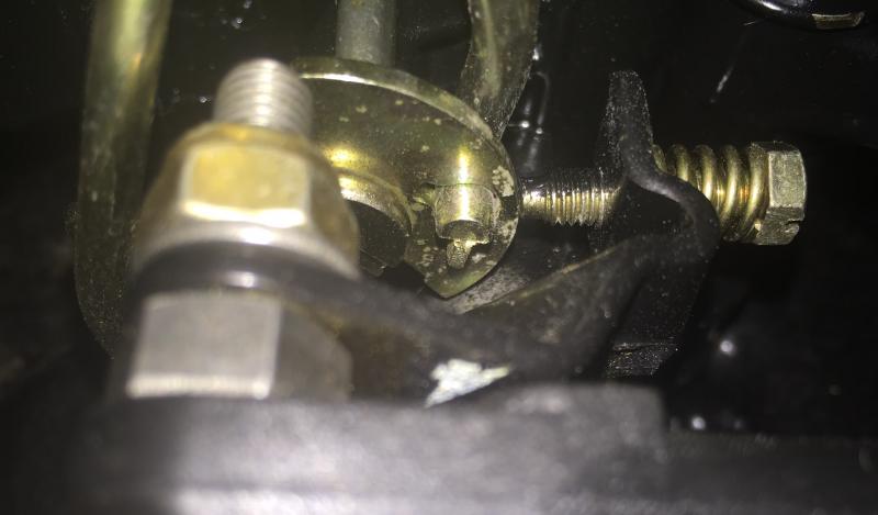

The idle screw is resting on the choke cam when placed into neutral with pressure for forcing it closed.

Re: "the idle screw is resting on the choke cam when placed into neutral with pressure for forcing it closed."
Not clear... You need to force it against cam, or throttle cable does???
When adjusting idle, disconnect throttle cable and adjust idle. Readjust throttle linkage to make sure it reconnects with carb without disturbing idle adjustment. You want a small amount of "bias" on that linkage to make sure throttle cable keeps carb throttle arm up against the idle screw when in neutral. It linkage worn, may need to fiddle a bit. And a Chris said, sometimes idle speed is high and drops, sometimes you need to very slightly "blip" the throttle.
Sandkicker - there is light pressure seating the idle screw against the stop.
On this setup the idle screw is on the throttle arm that pivots and open the throttle plate. The screw it's comes to rest on the choke cam.
I will turn down the idle speed a hair more and report back. Perhaps the factory tach is off some, at 650 it idles very smooth. My timing light unfortunately does not have a rpm read out like some to very the factory tach.
