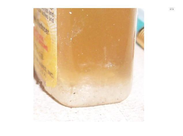

What I do at the begining of each season since the wonderful addition of ethonol is hook up a electic fuel fump to the fuel line before the filter. I then pump about a gallon of fuel out and into a clear milk jug. I then see how it looks. I have yet to not end up with at least a quart of water or worse in that 1st gallon
Excellent idea! Had I done this myself (and I'm about to) it would have saved me a bunch of trouble!
Here's what you're looking to remove (see photo): the white gook at the bottom of the bottle is that 4th liquid that forms in the tank thanks to ethanol. Not only will it not burn, no known additive will eliminate it AFTER it forms (and it goes right through filters). it,Only pumping the bottom of the tanks out will get rid of it.

Two issues there...1) that reduces your usable fuel capacity and 2) it doesn't eliminate the root cause of the issue. that crude will continue to accumulate and needs to be removed.
Also the water will go to the bottom and can lead to corrosion and a leaking tank. Get the gunk in the bottom pumped out, periodically spot checking it in a clear container.

Always a good thing when it is a simple fix. I just changed out the filters and did my usual pump a gallon out and as ussual had a bit of crud/water when I was done. About a quart between the two tanks.
I've got an issue with water/crud in one of my tanks. If I just pump out about a gallon will this take care of the problem or will I need to pup out the whole tank? I've got a photo but for some reason i can get it to attach?? I drained my Fuel/Water separator into a jar and about 1/8 of it was water and a thin layer of brown crud that settled to the bottom.
If the fuel is ethanol laden and hasn't started to decompose, you can pump the tank from the bottom, removing the crud and the water...if it has started to separate, you'd be better off in the long run emptying the whole thing.
