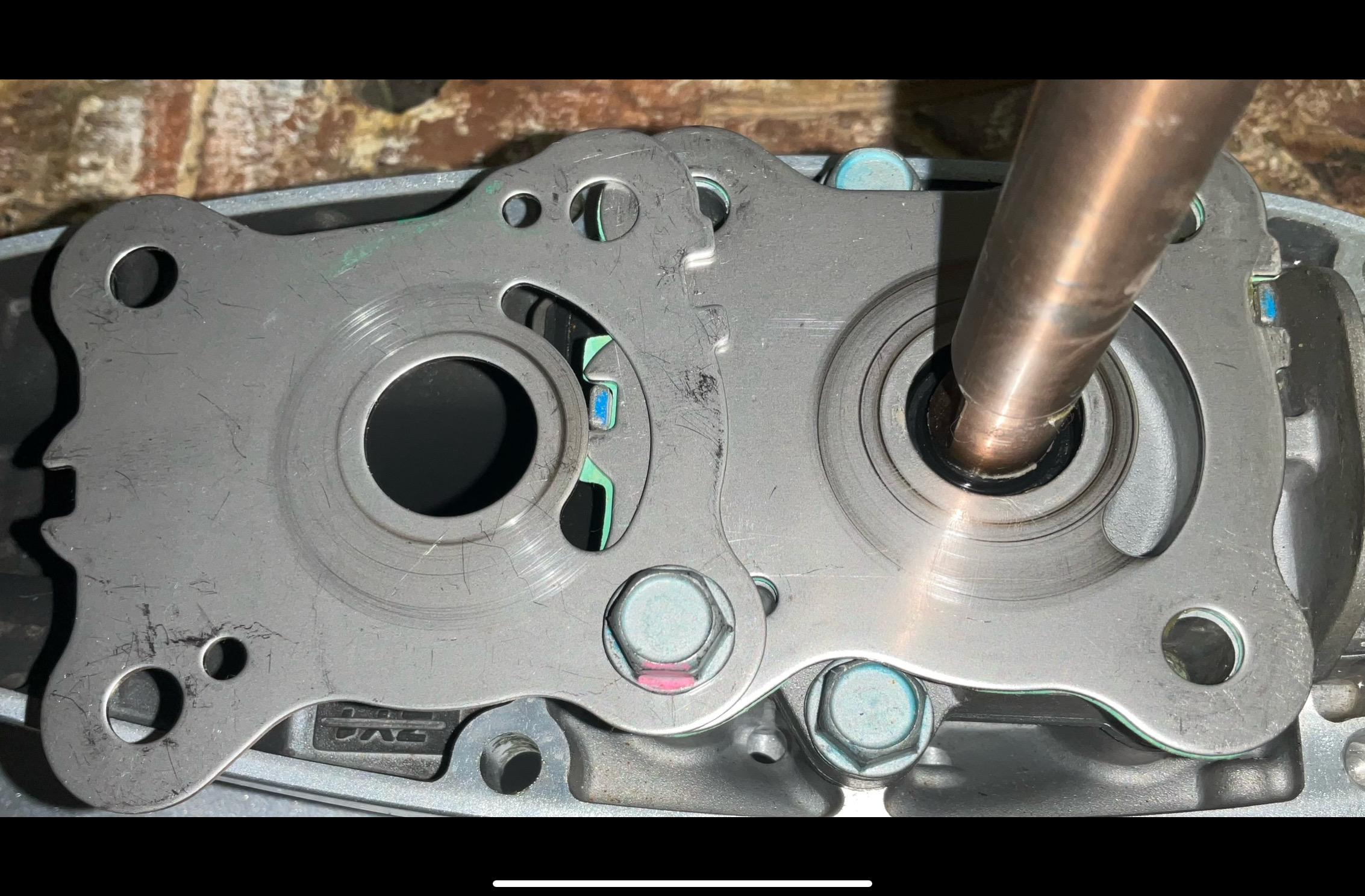

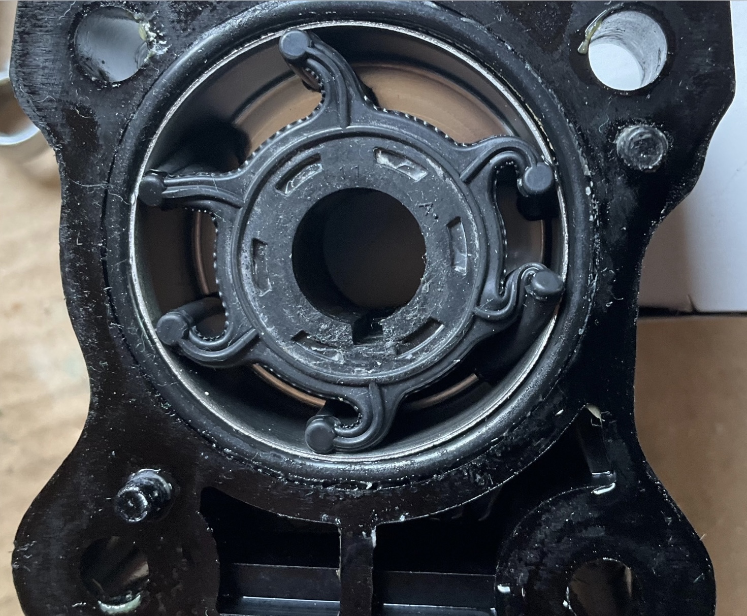

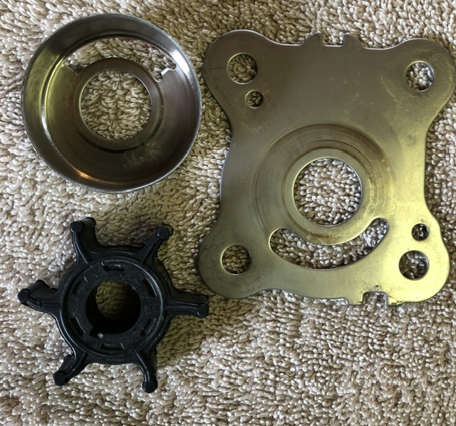

Entire water pump kit installed during the winter of 2022, I have about 35 hours of use between last summer and this spring. Started the engine up yesterday and noticed a week telltale upon start up, within seconds the telltale flow stopped altogether. Shut the engine down immediately. Upon inspection the vane at the 2:30 and 3:30 position are trying to climb out of the impeller liner. I’m guessing the impeller key jumped out of either the impeller or the drive shaft. I have on hand a brand new impeller, 2 keys, one spare that’s original from the factory with 5 hour on it plus the key that I suspect jumped out of the track with about 35 hours on it. Of course the Honda service kit is back ordered and expected delivery is June 19 IF it doesn’t get pushed back further. My question is, am I wasting my time installing a brand new impeller with a gently used key and using a 35 hour oring? Any idea why the key jumped the track, if that’s what happened?
