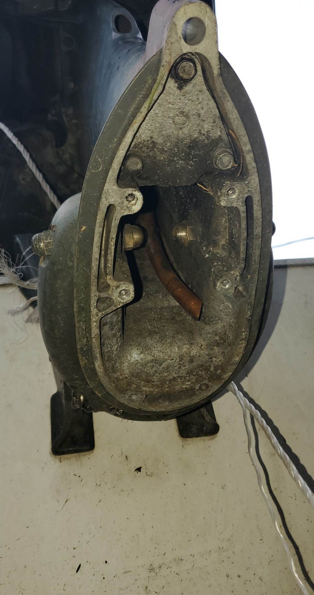

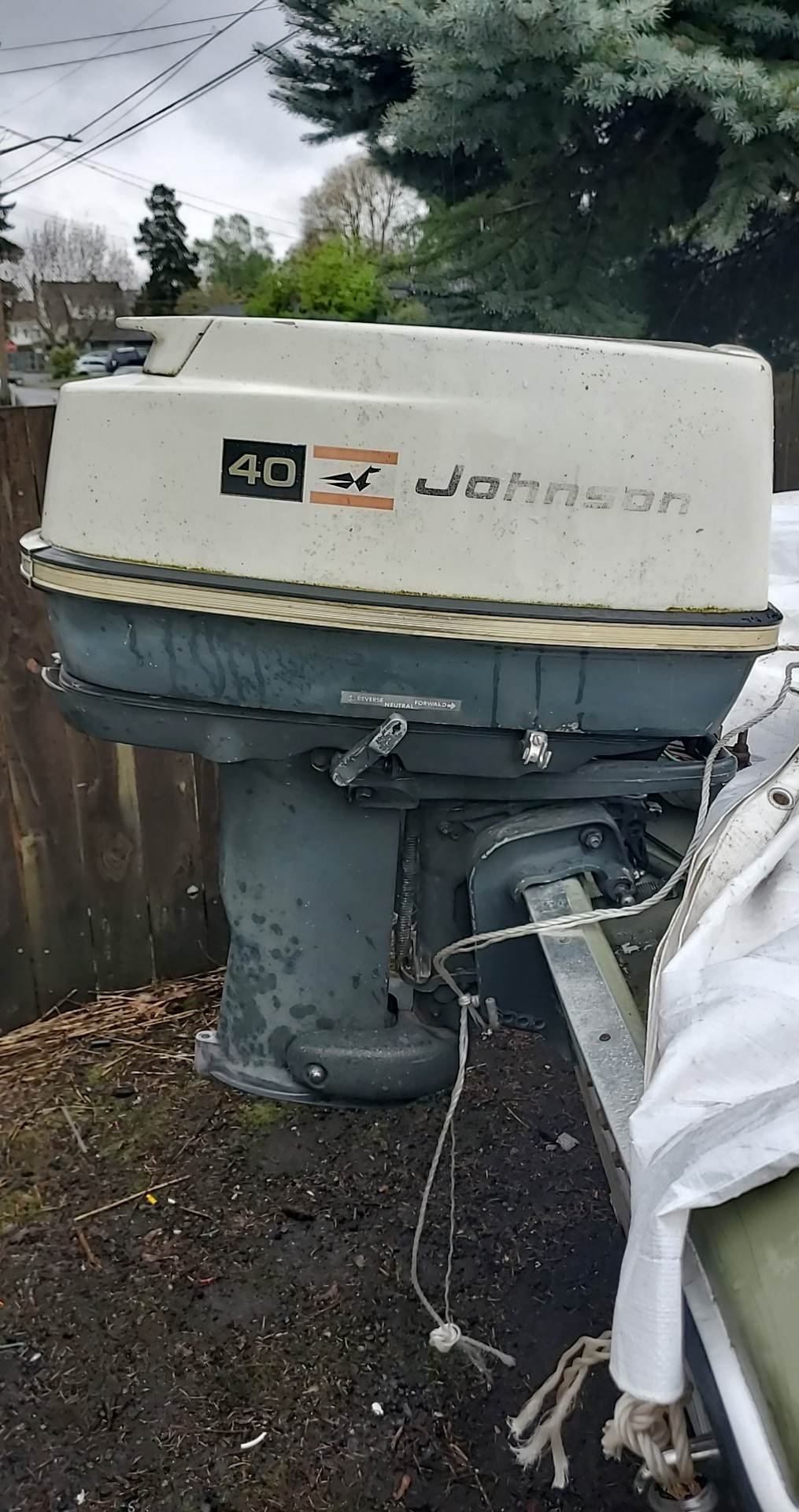

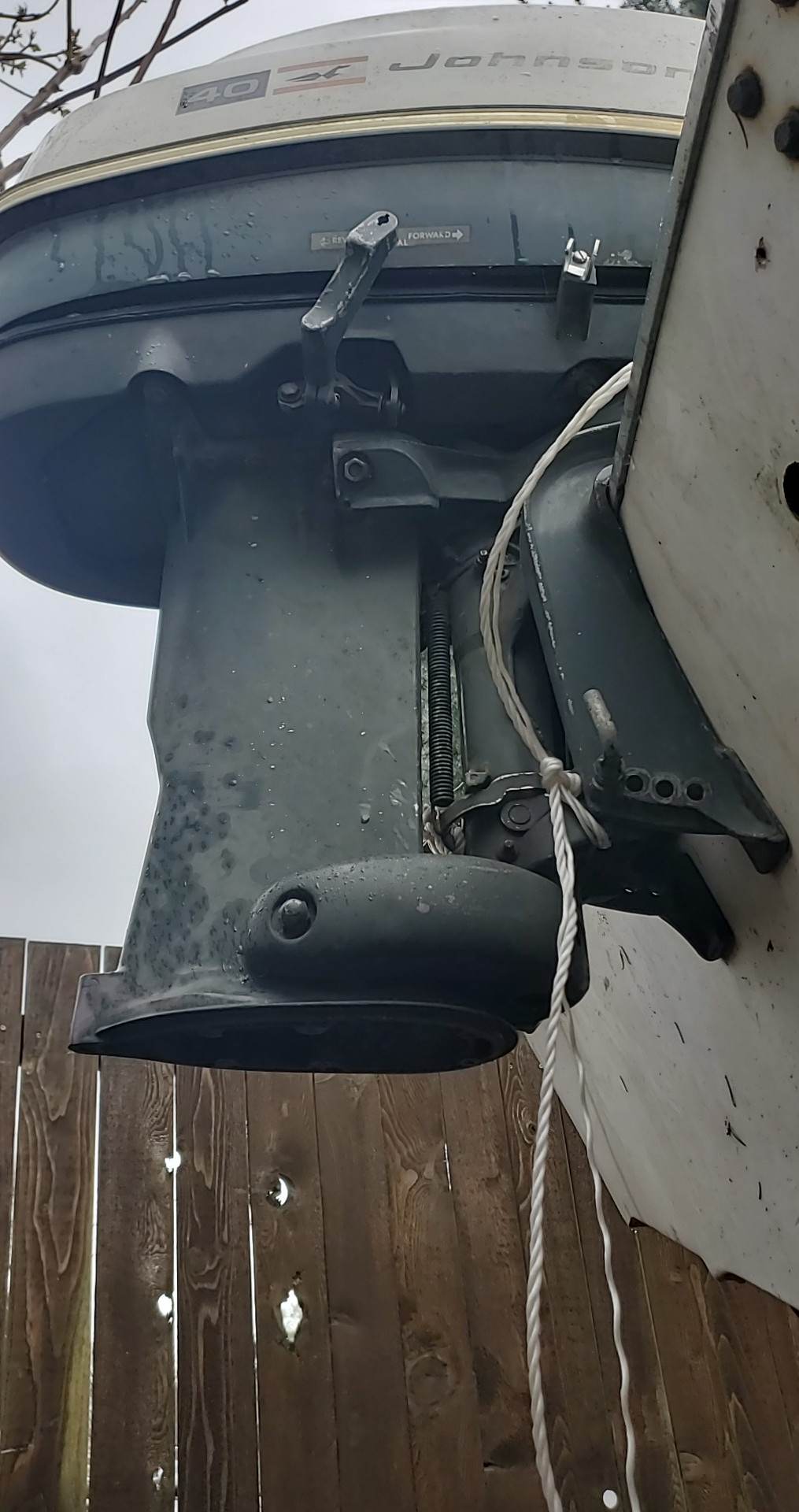

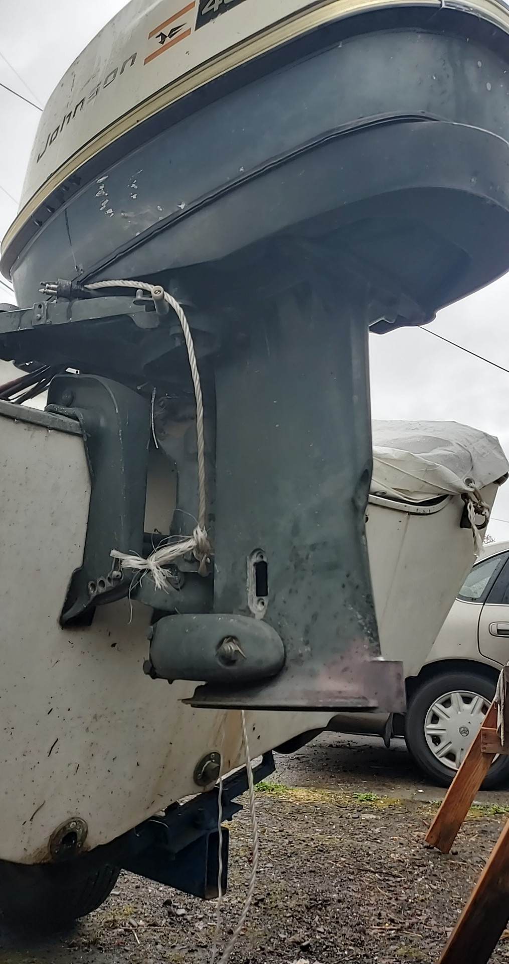

I inherited a 71 Johnson 40hp electric start with a bad lower unit. Can someone tell me all the years that are interchangeable with this one.
Thankyou, Jewell
Yeah, earlier 28hp-33hp Johnson & Evinrude, and Gail-built 35hp-40hp models. Heck, even some way back as far as 1955 will bolt up but you have to be careful of internal differences.
Pre-1971 J & E 40 hp won't work..
