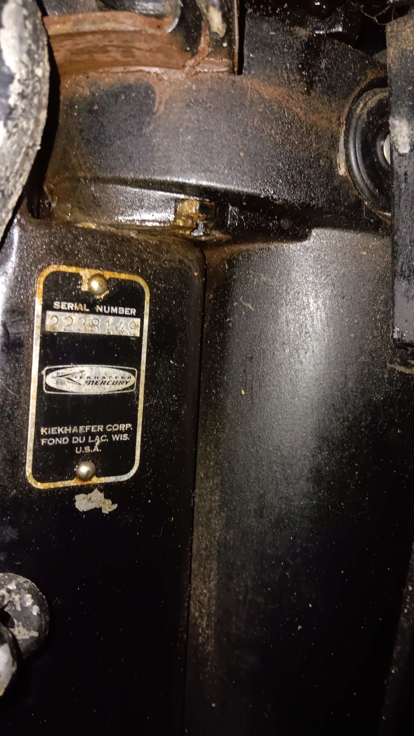

As the title says, I have a 1967 Merc 60 6hp unit I'm repairing. I've replaced the water pump and a few of the lower unit seals and its oil, all that seems to be working fine - but the cooling system keeps clogging with sand and rust debris. It'll push plenty of water for about 30 seconds, then it'll slowly taper off to almost nothing and I'll have to get the airgun out, remove the flush plug, and blow more crap out of it. It pushes water fine for another 30 seconds, rinse and repeat. I'm getting real tired of doing this, so if anyone has an idea on how to fix this permanently that'd be great.
