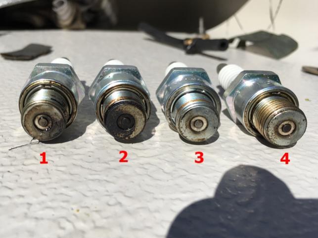

What's wrong with #2?
Dave1027
1988 Merc 100hp 2+2 motor.
Click on picture to enlarge
Might be a major carbon buildup on top of pistons. Have you ever tried a decarbonation treatment,sea foam, engine tuner? And yes I was leaning towards a possible weak spark. Has a compression test been run lately
Could be a bad plug wire also yes start off with a compression test and a open air spark gap test and get back with the results. Allways check compression first.
I have tried Mercury Powertune. As a matter of fact, I just did the treatment while replacing the plugs last week. The motor ran very well afterwards.
I have done a compression test but it was many years ago. At the time, the comp test showed no issues. All cyls were within 10%.
