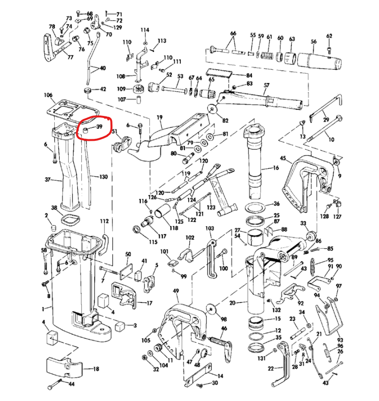

Test in a bucket as Racer described. If the problem persists, you may have a bad water tube grommet. I fought this same issue on a 1979 9.9HP and an old salt named Joe Reeves, who was an OMC tech for decades, said these grommets deforming and restricting water flow was a common problem on the 9.9/15 engines. Previously I had removed and cleaned the exhaust covers and head cover, replaced the thermostat, and installed a new water pump and still had water flow problems. After following Joe's advice and replaced the water tube grommet I never had another problem.
You will replace #39 Part Num. 0324045 and the powerhead must be removed for this repair. You will also need #106 Powerhead Base Gasket when doing this work.
