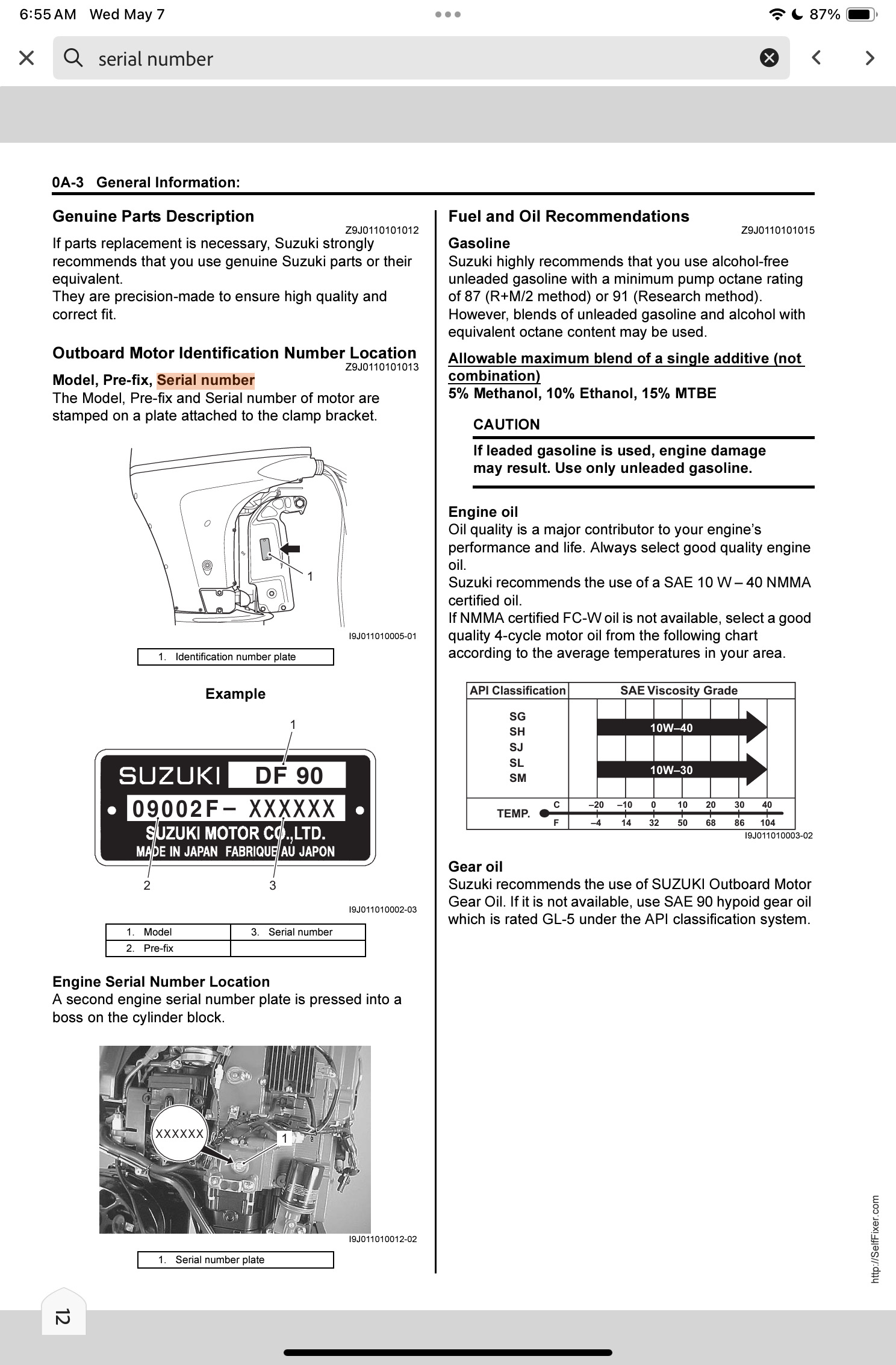

Also what what year could it be? There's no model number plate. I was looking for some serial numbers on the head like on Johnson engines but couldn't finid anything
