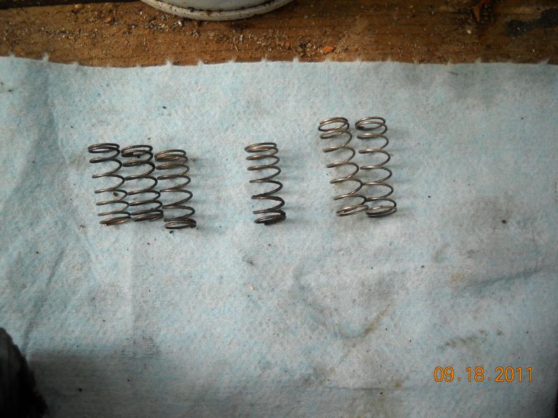

I pulled it apart.Saw the brushes were wore down and stuck.Springs were compressed a stuck.4Springs next to the right size2 after they were overheated
There was an obvious overheat situation as everything was cooked and carboned.

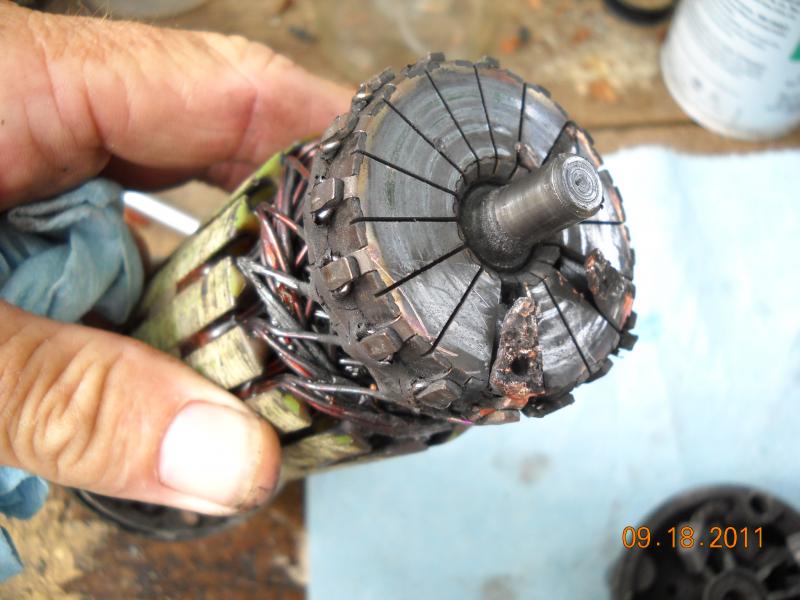

The armature where the brushes hit 2 of the windings were shorted out and destroyed the armature.
There was about a teaspoon of carbon/dirt in the bottom.See the pics.So clean or rebuild your starter at least every2 years.More if you use it a lot.J
