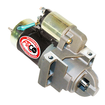

Merc typically used the 168 tooth ring gear flywheel.
If that is the case with your engine, it means you want the starter motor with the staggered bolt pattern, as per what Bt Doctur showed you in post # 4.
The starter motor with the straight across bolt pattern is for the 153 tooth ring gear flywheel.
I would look for a HTGR/PMGR (high torque gear reduction/permanent magnet gear reduction) starter motor for Marine use, like what Bt Doctur shows in post # 4.
These are gear reduction and will spin the crankshaft faster.
Example:
