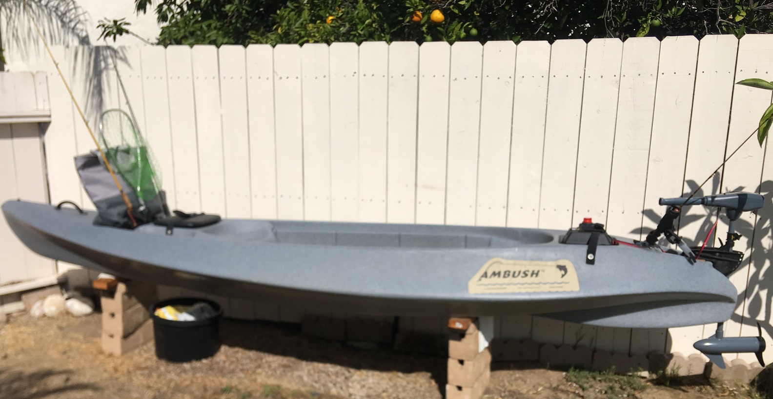

So I just realized. I have this older kayak that is somewhat rare in that it has a transom at the back. this transom is a plastic shell, without anything inside of it. So based on the fact that this kayak exists, and that it has an empty transom with nothing but air inside we now have proof that little to no design goes into transoms and that you really don't need any backing at all! anything from a kayak to a 4,000 Lb. deep sea rig! All you need is air inside your transom!!! You cannot underthink a transom. It is not a vital part of the boat that keeps water out and handles all of the thrust and steering needs of the boat. They never leak, and a motor has never ripped a transom of a boat before.
Picture of the kayak that proves this concept!!
