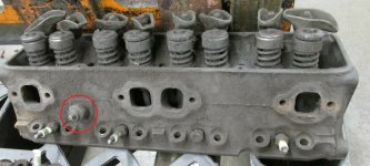

I wish there were provisions on the intake or the T stat housing for the sending unit. there is a Tee that feeds from the exhaust manifold to the T stat housing. One end is capped. I can try installing it there. It is the feed to the T stat housing. Feed comes from the top of the exhaust manifold to the bottom of the T stat housing. From there the Tstat opens up and water rises to the top of the T stat housing and exits thru a hose on each side to the exhaust elbows. Until the T stat gets hot enough to open the water exits thru the bypass pop up valve inside the top of the T stat housing to the hoses feeding the exhaust elbows
I do not see anything on the head itself however there is a brass threaded plug on the right side of the engine block (viewed from the rear looking forward) centered below the center exhaust ports but in the block itself.
this is where I was referring to:

in a car, most people use the drivers side head....that said, I would say either is viable and I would chose the one the has the better access...
Going to have to go to the boat and check the access. I think the manifolds will be in the way of the plug removal and temp sender installation. The block has a plug about half way down mid block looks like a drain plug for the water jacket on the block. Is this a good alternative?
Was looking online and saw some radiator hose adapters that had a bung for a temp sensor welded on. Cut the hose and insert adapter inline with the hose. Maybe this would be a good option? Installed in the hose that feeds the thermostat housing
the drain plugs are usually lower than the freeze plugs...two issues with these - 1) size isn't big enough for typical sender unit & 2) location is on the 'cooler' portion of the cooling loop...in other words, it won't reflect what is going on up at the thermostat.
