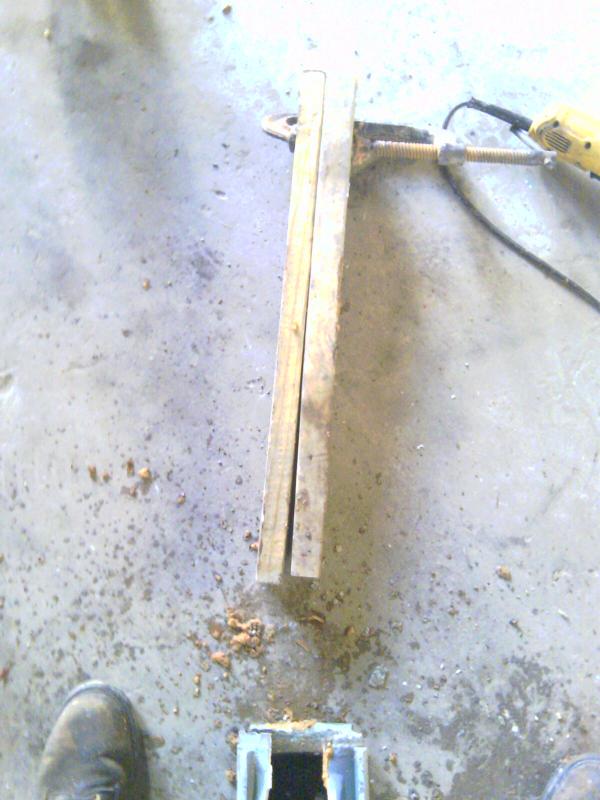

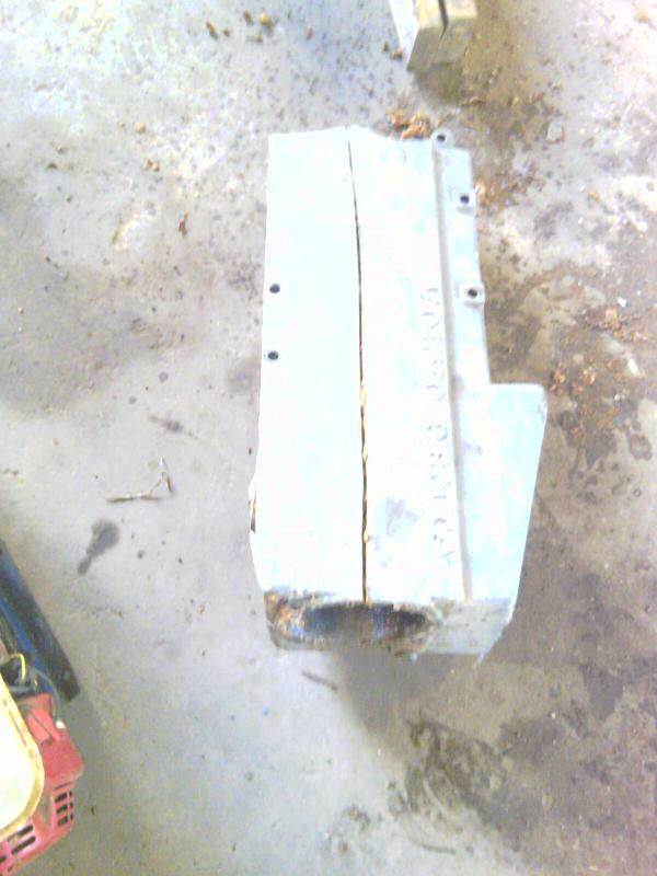

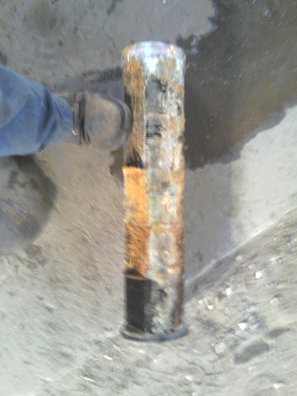

Here are so photos of the bundle I removed from a tank today. First, cut down the side of the tank with a cutoff wheel to free the bundle. Next place 2 2x4's in the rear of the bundle and use the whole setup as a pile driver. The slit I made can easily be repaired by an aluminum welder. 063.jpg062.jpg060.jpg061.jpg
