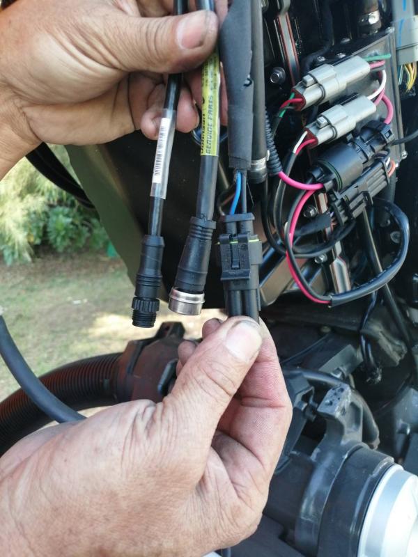

now, I am not sure is that trim sensor need replace new one? or lose connecting? or need computer to setting program?
whatever up end or down end , the gauge always show Trim 100%.
due to Trim 100% status signal give outboard computer, the outboard is limited output maximum RPM 2000 only, can not going up over 2000 RPM.
2. I asked BRP service try to maintain, but I can find out any triangle program connector...
please check pictures,
I looks youtube video, seem is this triangle, but still can not find....
