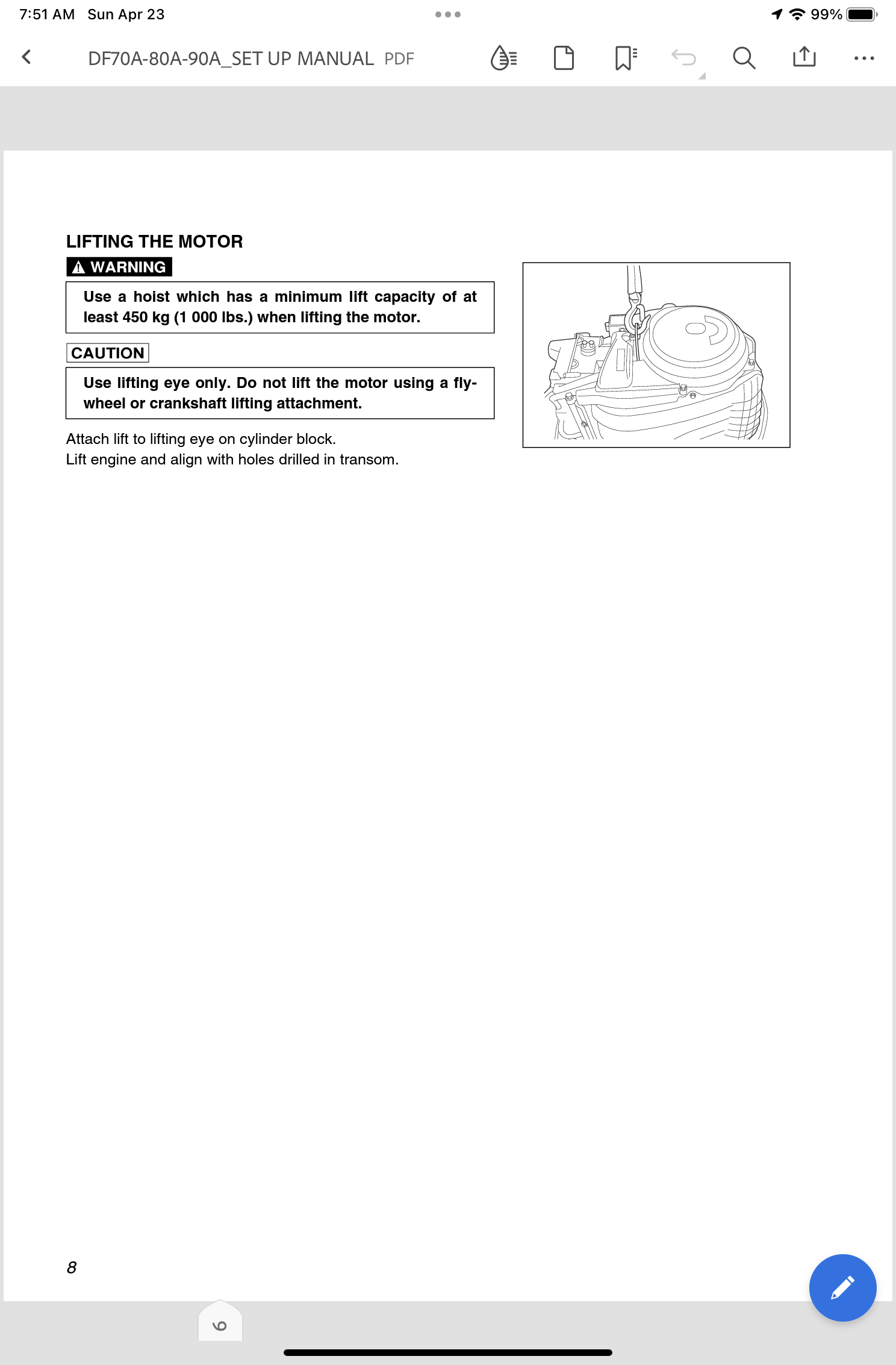

I need to remove my DF70 from my boat. There are what appears to be two different lifting eyes on the engine - one on top of the intake manifold and the other on the opposite side and rear of the engine fastened to the engine/head cover? Am I supposed to use both eyes simultaneously to lift the engine? Or just one of them? Any advice is appreciated.
