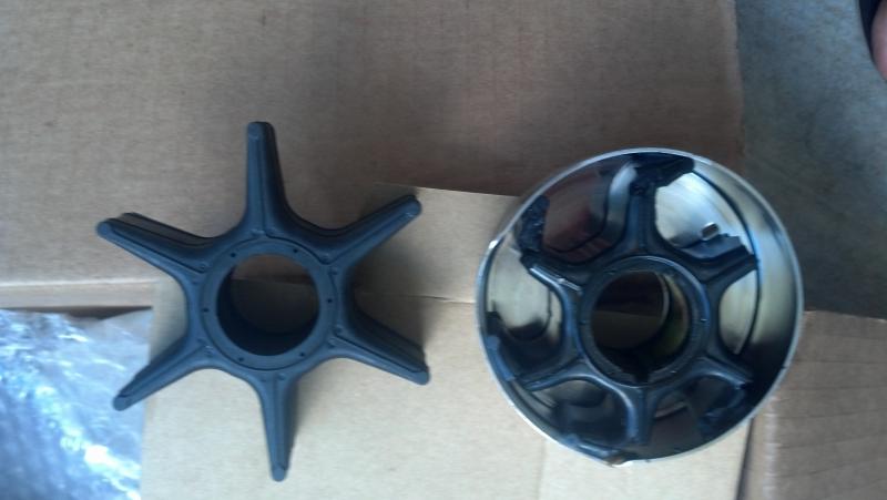

Wow!!!! Huge surprise on a Honda impeller---I thought you needed a hand grenade to break off a Honda impeller blade
What's MORE important is what you DIDN'T find! Have you accounted for all the missing pieces?
I think so. In my opinion I think that if the pieces of the vanes came off in one piece, I doubt if they could make it through all the water passages and out the exhaust on their own. I'd first look around the t-stats. You'll need to remove them anyway to reverse flush the engine.
The trouble with using the tell tale stream to determine if there is "adequate" cooling is that it CAN be deceiving. While it certainly tells you that the pump is pumping a generous supply of water, it is a "branch" circuit to the cooling passages and can be completely clear while a blockage could exist in the block very near the "T" junction or, where smaller pieces come off, in the thermostat housing or even the cylinder head.
Like Mike says, the pieces tend to fall down when the engine is stopped but can be pushed up the tube when running.
Having debris UNDER the pump could lead to having it "suck up" while running hard and entering the pump housing. This could destroy your NEW impeller.

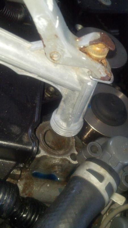

Can someone give me procedule on back flushing.I e. Pullling. The thermostats
Do I back flush using hose flush connections w foot off and thermo stats off ?
While pump was apart I didn't see rubber fin from old impellar
I don't know if this is the correct way to do it or not. What I have done in the past on other motors is to remove the lower unit then remove one t-stat at a time, put the end of a garden hose in there, seal it with a rag and duct tape, and turn on the water.
A local marine mechanic does the same thing but uses an old sump pump on which he has reduced down the outlet to fit a garden hose. He'll set that in a bucket with a mixture of Salt-a-Way to de-salt old corroded engines.
I've never done one of the larger engines but I too would go with chawk_man's suggestion, knowing that he has a methodical and logical approach to doing things on his rig.
But here's the fun part for me and why I "lurk". You, Capt., always seem to have some insightful observations when you do things as well so I'll be waiting to see what you come up with as you work through the task.
I really DO like that sump pump/salt away trick.
One trick I have for flushing is to use a toilet valve flapper with a hose adapter to seal the stat opening for flushing. I also have one rigged with an air hose nipple for blowing through the system with shop air. Works on some engines but not sure how it might apply here.
Good luck.
IMG_20141004_101443_319.jpgIMG_20141004_101431_180.jpgIMG_20141004_101443_319.jpgIMG_20141004_101431_180.jpg
ok so I took thermostats out poured a little salt away in each side used hose nozzle to flush out chambers dumping water into bucket to catch any pieces. There was no visible pieces so going to water test and keep an eye on it for the next few trips out not sure what happened to piece of Impellar. I also took flash light and looked up water tube , it was clear no blockage. I used weed eater line to ensure pee hole tube was clear also. Tryed blowing air thru pee whole to no avail. If issue arrives will pull side cowlings off try blowing air thru block connection where pee hole hose connects maybe w thermostats out?
