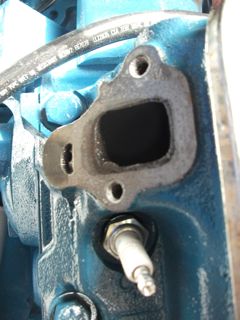

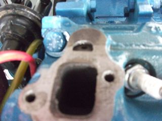

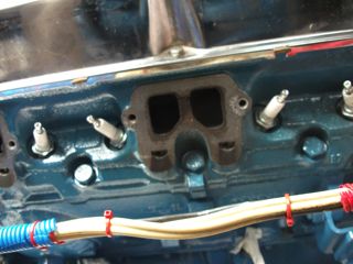

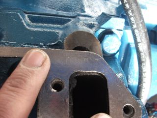

Can you guys please help me id what sort of head I have here. The machine shop put them on with the wrong gaskets, I have found the right ones, but I am interested in figuring this out. I can't find a reference to these lower holes.

Huh! Those have to be some kind of automotive heads with emissions ports for EGR. (Never seen anything like them before.) Obviously, water and or air is going into/ out of those little holes and causing all kinds of hell!
!. The heads have to go. Period. If the company who sold you this motor as a MARINE engine, then they owe you another engine that IS a marine engine.
2. If you bought this motor NOT as a marine engine.... Too bad.

These are "air injection" holes. I used to run these heads on my race motors. All you need to do is run a tap through them and install set screws with sealer.

Those air injection wholes are legit and don't indicate whether they're
marine or auto head castings. The exhaust manifolds tell the tail.......
Chrysler made 2 different manifolds up until '75ish and beyond. the earlier ones came to a point along the top and looked like a triangle when looked at from the end. The newer ones are the ones we're more familiar with the squared off top which allowed bigger water passages but another difference you wouldn't notice unless they were side by side is the newer manifolds have longer 'tabs' that hang down from the exhaust port opening to cover those injection wholes since marine engines aren't emission compliant.....It's no coincidence that the newer manifolds came out at the same time the emission requirements started to mandate changes in their automotive engines.
You could either go back the the original gasket kit made for your model exhaust manifold with the 3 individual gaskets or put set screws in there like suggested before.

The ports and valves are also larger in the automotive heads, where the marine heads deliver better mid-range torque. Be careful of a port mismatch on either side of the heads and you'll be okay. And use a sealer when you plug those emissions holes.
Thanks Jack, we did get the three piece gasket set and covered over the holes.
