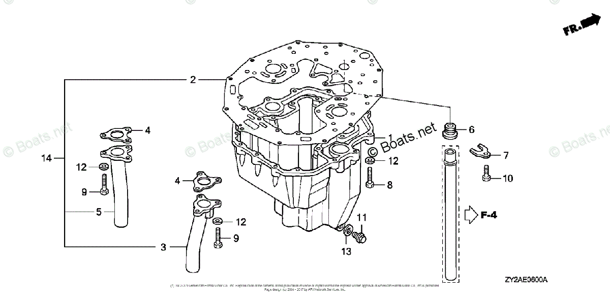

Overheating issue solved. The problem was that the hose that connects the lower of the mainfold to the block was had corrosion all around it thus the inner came thinner , thus less water flow !. Tried and tested on water and now ok. Thanks guys for your help , you made me keep going !!!! I need last help from you , do somebody know the procedure to replace the the water tube grommet #6 ? NjM2OTM-a862f5ab.png

Replacing that grommet is no big deal but getting to it might be hard. I don't know because I've never done one on a big Honda. If you can see it after pulling the water tube then it shouldn't be too difficult. If you have the extra long extension case, that will make it harder. I hope you don't need to pull the case to get to it.
You just may need to make a couple of tools if reach is a problem. I use wooden dowels and pvc pipe to fabricate stuff like that.
There's nothing special about those grommets. They just push into place and the molded in "ribs" hold them in there. You just pry the old out, and push the new one in the hole. Using a little marine grease or even Vaseline to lube the ribs might help get it to slide into place. Once the water tube is properly installed, the grommet can't back out.
Good luck.
I removed it by making some tool and some welded fishing hook in the front , easily came out as it was worn out as well. I can do the same thing to replace but i prefer to remove the extension case if there is a possible way to remove and have an easy access and also check visually the state of the oil pan.
Well, I think removing the case and inspecting the pan is probably a good idea but I can't offer any tips on removing the extension case. You don't have the shop manual?
