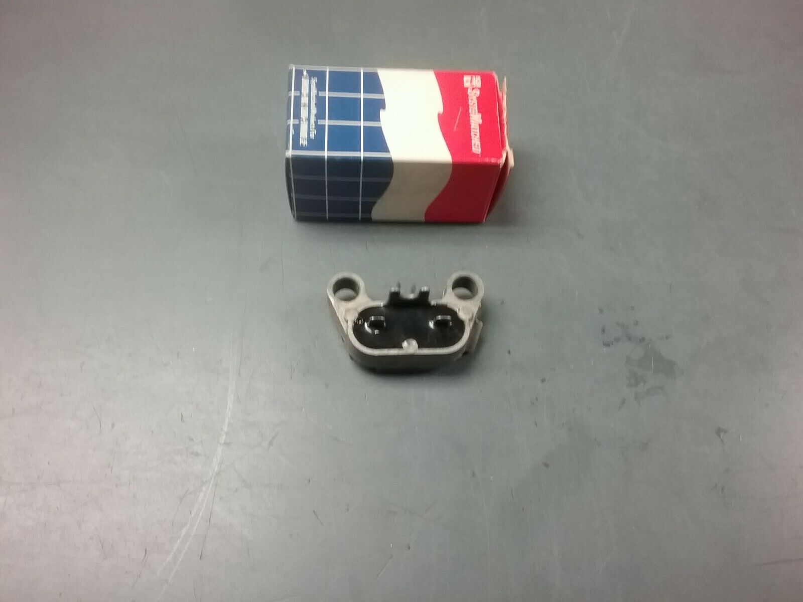

What does the heat sink and diode do?
Along with the other pair, they form a full wave bridge rectifier. In plain-speak, they convert the AC alternator output to DC for charging the battery.
Around 13.5 / 14 volts at a fast idle.----Model # of your motor ?------Those 2 diode parts are cheap.-----Might not hurt to have spares on hand.----Your location ?
You know the diodes are good because it obviously is charging. Besides, that type was very durable.

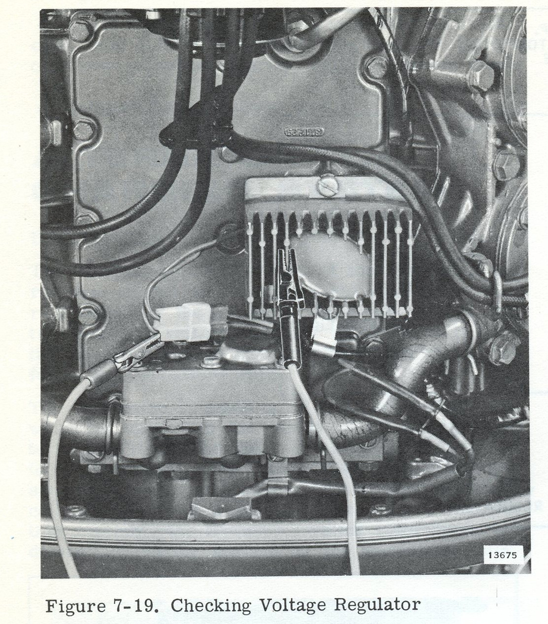

Voltage regulator: From the factory service manual: With the solid state regulator, there can be only two types of failure, under (no) charging or overcharging. Run motor at least 20 minutes to stabilize the regulator. Then with motor running 2000 RPM and all accessories off, check the voltage at the regulator red wire. If the voltage is in excess of 15 Volts, the regulator should be replaced.

The book is sort of confusing. In one place it says to check voltage at regulator. another place simply says "check battery voltage".

You got me pondering on this one. Studying the system and how it works, the regulator is monitoring the voltage on the red wire as it is presented to the regulator input. Therefor, it should be measured at the regulator red wire, as instructed and shown in the picture. If it "sees" more than 15V at that location, it should cut back on alternator output. Measuring it anywhere else introduces the possibility of error due to other possible faults. Now to relax my brain awhile. Whew!
