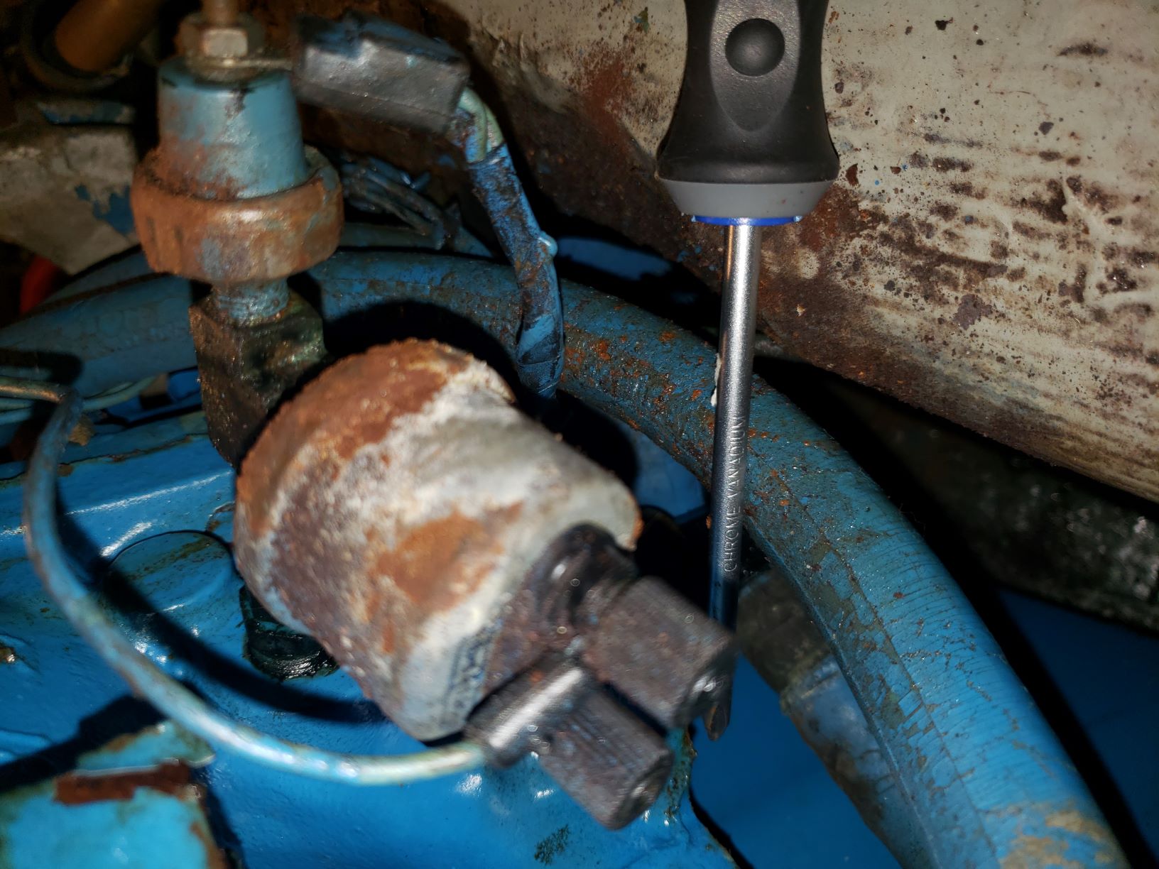

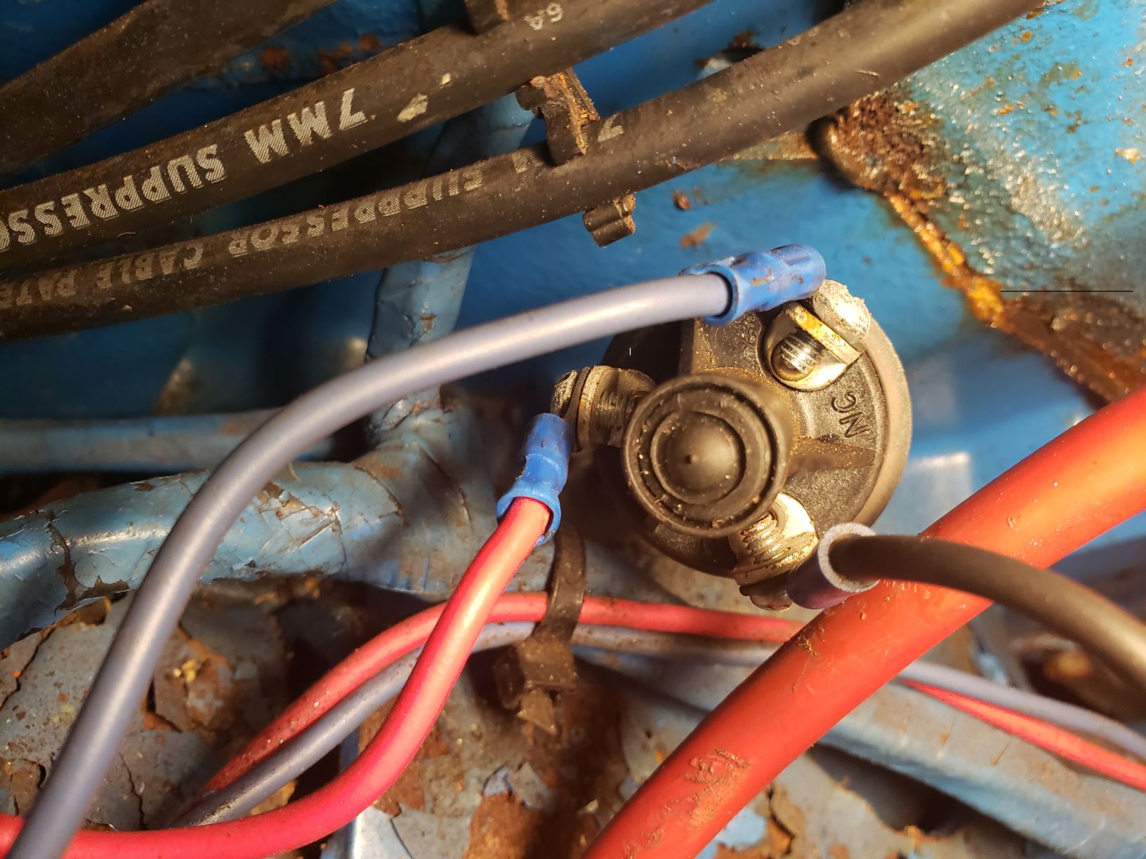

I replaced the 3 post switch but don't know what the other 2 are. Any help?

I'm getting 12v when cranking and the fuel pump is working but when the engine starts I lose 12v and the fuel pump stops. Would that indicate a bypass circuit issue like the 50amp relay/breaker located in the circuit? I have good oil pressure a new 4 psi oil sw.
assuming you are referring to +12VDC at the fuel pump, and it isn't there once the engine starts?
That suggests the supply side (with the engine running) isn't supplying current or you have the wrong oil pressure switch...
