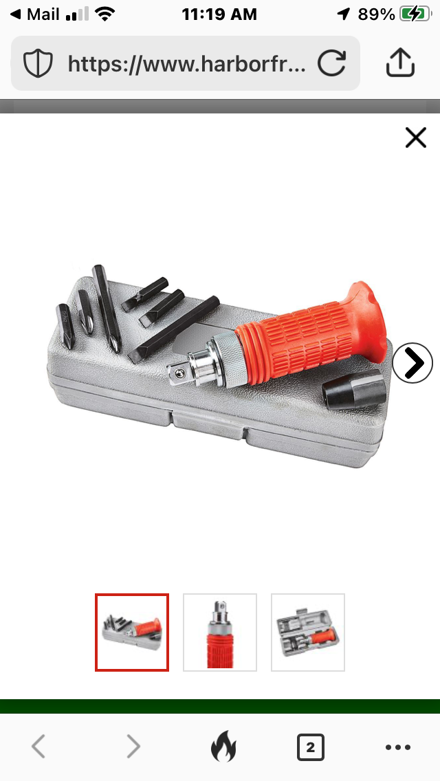

your gonna have to find a way to heat the screws up and get em pretty hot without heating the aluminum around it too much and use some penetrating oil. you may have to use a impact like this.
but be careful not to knock the head of the screw off cus then your up crap creek without a motor or paddle. oil tube is 203433 this site says it has 10 of em
your gonna have to find a way to heat the screws up and get em pretty hot without heating the aluminum around it too much and use some penetrating oil. you may have to use a impact like this. View attachment 31044but be careful not to knock the head of the screw off cus then your up crap creek without a motor or paddle. oil tube is 203433 this site says it has 10 of em
Thanks I looked on harbor freight they have a similar one. Thanks. Basically you have to hit the end of it and it spins.
I went to harbor freight and bought this for$10
