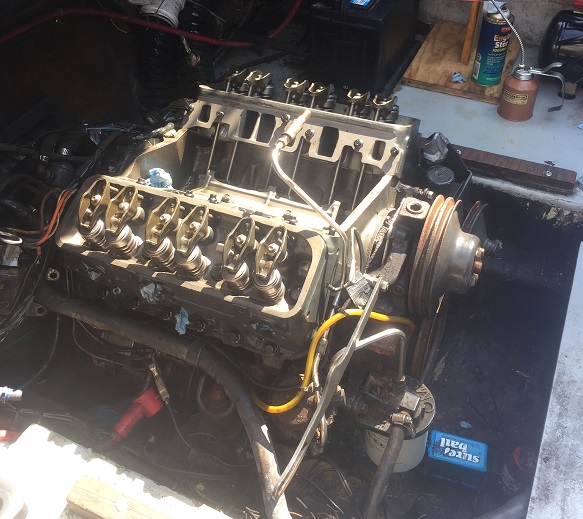

I have a 38ft SeaRay with dual mercruiser gas engines. I was cruising along and one engine started making this noise. Can anyone tell me what is happening here?
I agree, rocker arm sounding , If motor performance is still good suspect a rocker arm loose,stud pulled etc. If performance is down suspect a stuck exaust valve,
could be a few things, bad valve lifter (doesn't pump up like it should), bent pushrod/stuck valve, loose rocker retainer bolt, rocker stud pulled out, for a few.
if you are going to go at this familiarize yourself with the procedure for adjusting the hydraulic valve lifters.
