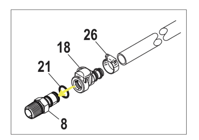

I then pull off the quick disconnect fittings from the underside of the engine block to make sure all of the water was drained. I didn't get any water to come out, so I assumed it was drained fully. I had remembered many people discussing how these ports can get clogged and trap water in the block. They can get clogged with sand and scale, etc.. So I decided to grab a small screwdriver and poke up into them to make sure they weren't clogged. Sure enough, they were clogged. I poked through the sediment and began working it loose and breaking it up. The water started pouring out of the block. Absolutely nothing had drained from the block when I followed the service manual instructions of pulling the 3 blue drain plugs!

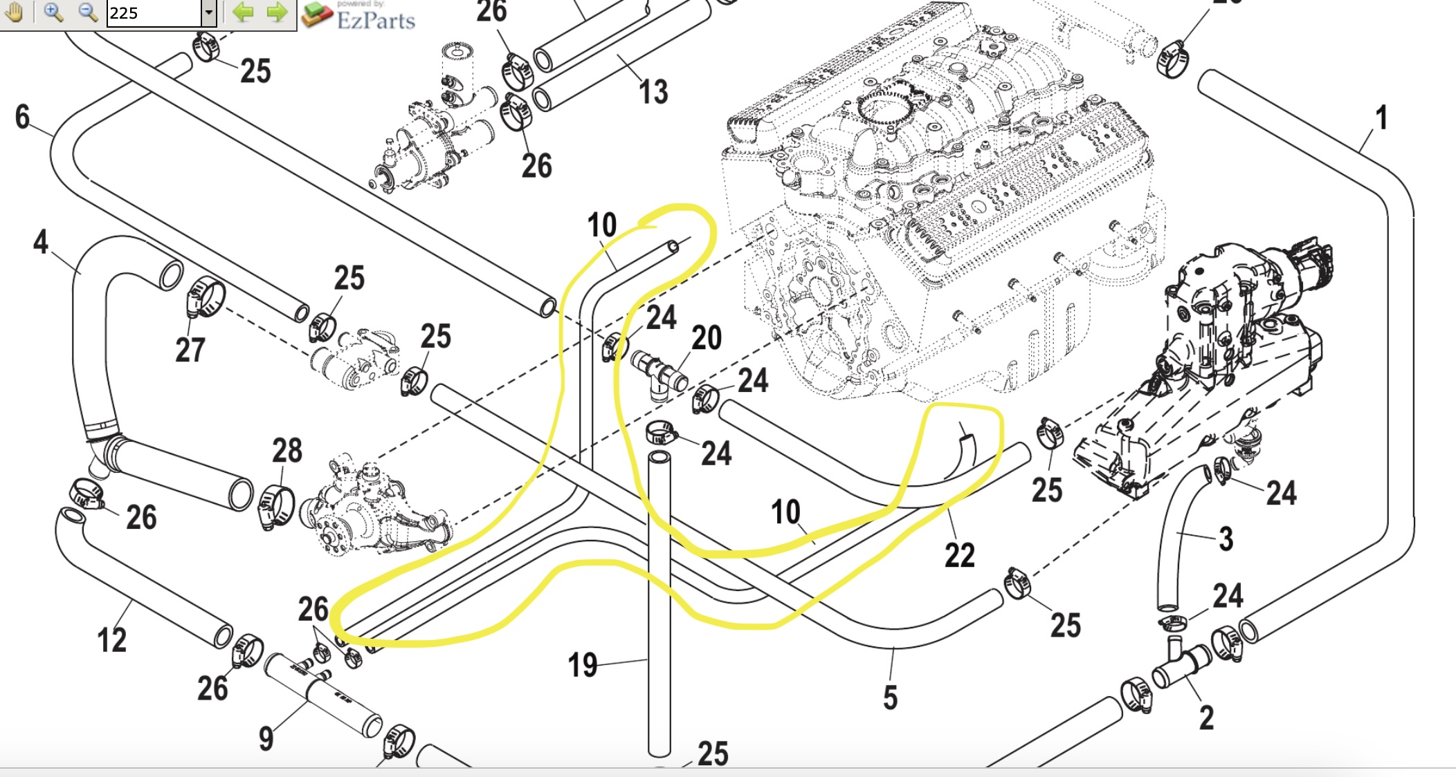

So...lesson to anyone reading...if you have "automatic" drain hoses that exit the bottom of your engine block on both side (see drawing below) - then you absolutely need to pull them off during winterization and poke up into them to make sure all of the water has drained from the block!

Excellent post, this is something that's been discussed many times, and some advocate removing this system and going back to the normal simple drain plugs.
Correct Louc, I recommend removal just for that exact reason. Install regular manifold drains with the blue plugs, remove the block fitting and hoses, install the brass block fitting with the blue plugs cut the hoses short and loop them at the drain manifold at the front of the engine
some have an additional hose to the exaust manifolds with a check ball system. the second red loop is for those hoses
