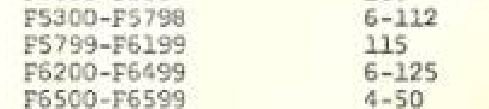

Bisonboytwo
These are some of the numbers I located on the graymarine engine I am trying to find a date for. This is model 115, engine number F5939-1. The brass tag on the carburetor has what looks like two different concentric number sequences E64236M and S639C. Also there is a casting on the block 55050. Are any of these a clue to the motors age? Dan

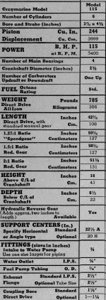

Lepke
As above 1950-53, model 115, see attached. Other numbers on the block are casting numbers and nobody has those.
The files model 115 come from one page, but the forum limits a jpg to about 1000kb so I had to split and grayscale one.
Gray Marine is long gone, but if you need to overhaul, any decent automotive machine shop should be able to get pistons, rings, valves and maybe bearings. Rod bearings may be babbited. Gaskets would have to be hand made.
