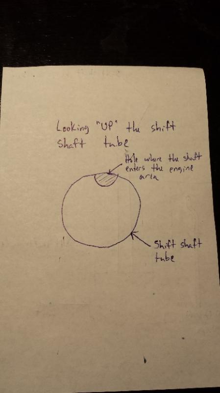

Thanks for your reply. So you are saying the shaft should be pointed back when inserting, then once it's close enough to start bolts, use the needle nose to turn the shaft correct orientation. I have attached a couple sketches of what I'm seeing. After looking at the photos, does this seem like the same problem you had? I will definitely give it a try. The shift shaft must take a bend in the tube at the top. The very top area where the bend is looks like metal and the shaft seems to be binding at the very top and can't make the bend at the top to get fully into the upper unit. In the second sketch below, you can see the view from looking straight up the shift shaft tube. The hole where the shaft enters the engine area is at the top. I have tried greasing the snot out of the tip of the shift shaft to try and help it slide easier in the bend but no luck.

Wow...so simple...after reading the replies carefully, a light came on. I had no idea the shift shaft is exposed between the tiller arm and upper unit! So I went ahead and lifted the lower unit until it stopped then clamped it in place with woodworking clamps and used a long screw driver to push the shaft forward into the hole leading to the upper unit then presto! I turned the prop which indexed the drive shaft splines and bolted it up. Perfect! I filled up the gear case with gear oil and fired up the engine. Tested that forward, neutral, and reverse work as they are supposed do and all is well. Thanks so much for your support and tips. For anybody stuck with this problem reading this post in the future, see the attached photos of where the shift shaft can be seen and accessed between the tiller arm and upper unit. And lucky me, I didn't even have to take the lower cowling off!
