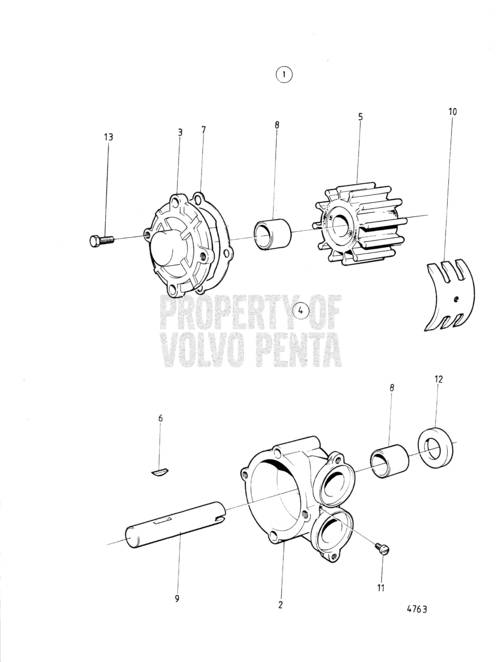

I have a 1983 bayliner with the AQ 125A motor. I have installed the hotspark ignition (GREAT MOVE!!!) and changed the propeller to a 15 by 13. It now runs at 2900 wot and does 36 mph. Cruise at 2100 is still doing 30 mph. This is good, but now the water temperature shoots up and the motor overheated. I waited until it cooled and it started and ran back to the dock but now if I go over 2100 it overheats. I replaced the impeller in June and was very happy with the changes made thanks to the input from this forum's members. My question is this; what is the equivalent volvo automobile for this unit? I recall something about a 240 2.1 motor, but I cannot find that thread. I would like to know what is the correct motor for cross reference, as I think I will replace the water pump also, thinking the automotive equivalent is less costly than the 375 dollar marine unit. Any input?
